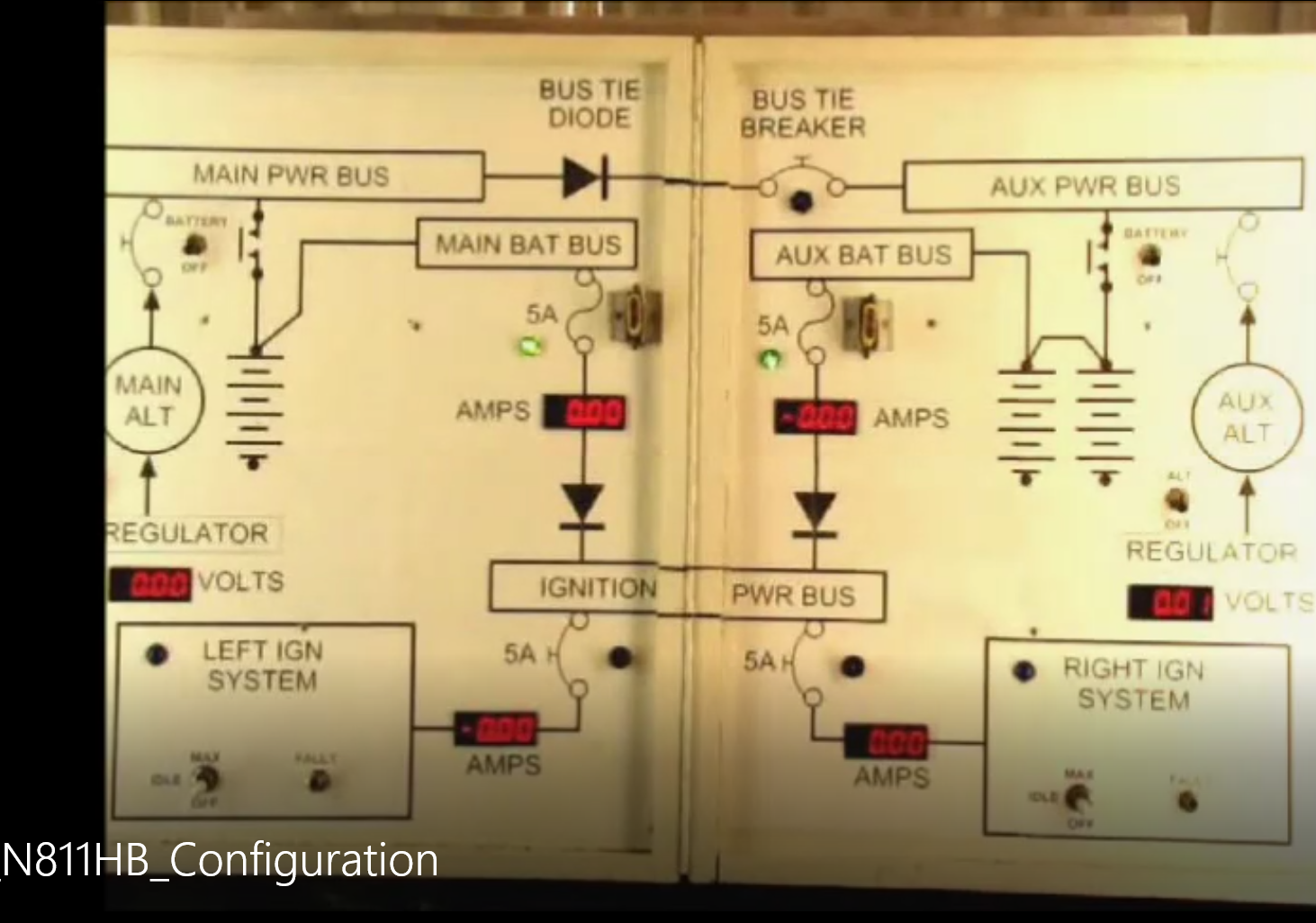

I do understand, as importantly shown in the N811HB accident investigation, that failures that have no effect on the current flight should be detected before the next flight! Those unfamiliar with N811HB may well learn more than one lesson at http://www.aeroelectric.com/Reference_Docs/Accidents/N811HB_Feb2008_LA-IVp/
This is an example of a system that was DESIGNED
to fail. The builder attended one of my seminars
out in Eugene OR some years earlier. Had the book.
Was assisted by a degreed engineer neighbor.
The same neighbor adapted Z-14 as a recommended
architecture for a high performance airplane
carrying a full-up compliment of Garmin glass . . .
but then ignored the advice offered by his
own recommendations by bringing BOTH ignitions
to a common bus with a poorly crafted constellation
of protective devices.
The whole point of the Z14 philosophy is
independent redundancy . . . but lost in
this airplane by adding a feature that negated
that philosophy in a catastrophic way. The
feature? A dual diode feed common bus for
both ignitions.

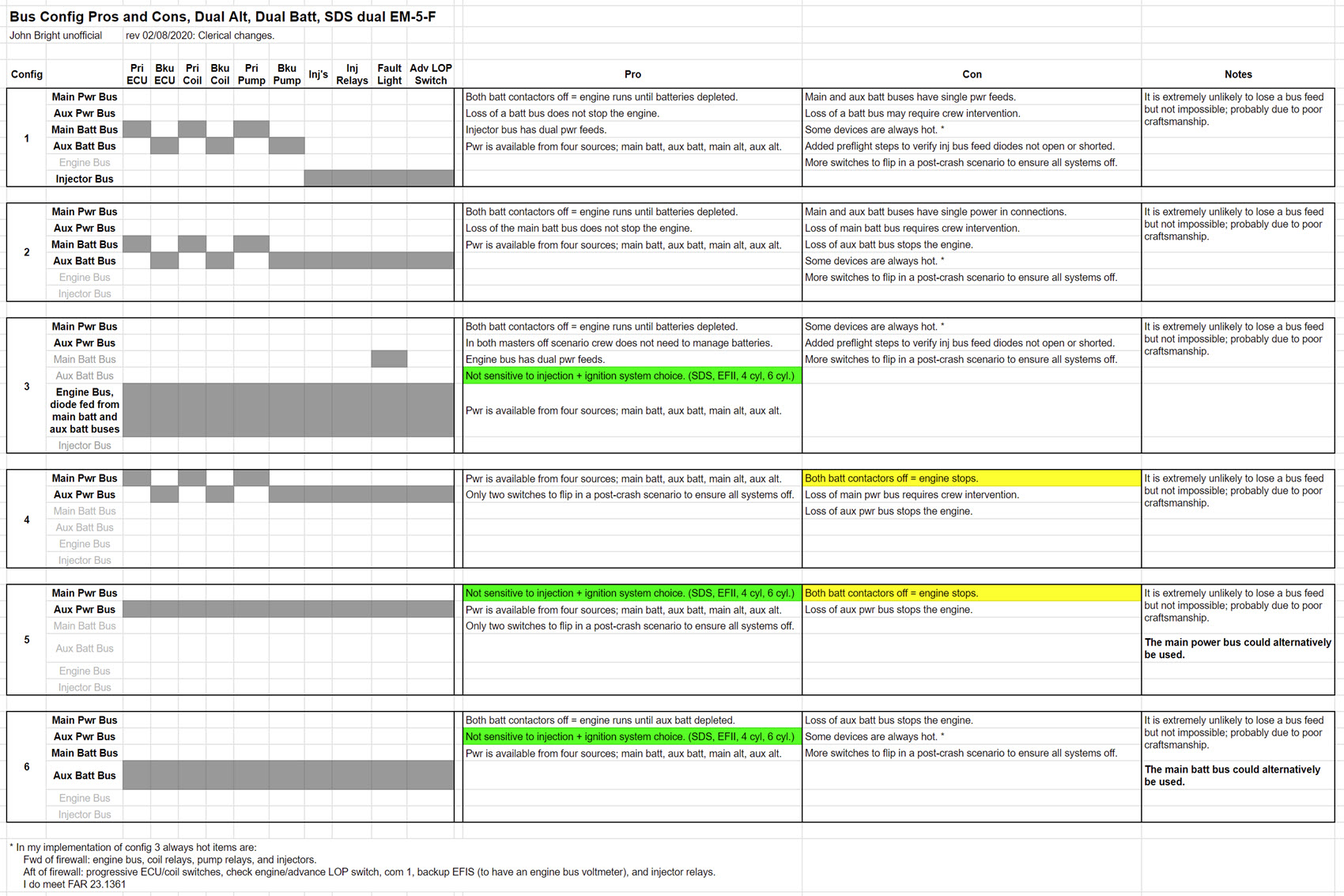

PostPosted: Tue Jan 28, 2020 5:25 pm    Post subject: Re: Proposed Z-14 implementation Reply with quote
nuckolls.bob(at)aeroelect wrote:
At 02:29 PM 1/27/2020, you wrote:
Okay, riddle me this . . . suppose all injectors were
powered from the aux bus of Z14. Deduced and cite the
failure that would bring the aux bus down . . . and
what would be the mitigating action?
Thanks Bob,
The feed to the bus itself could be interrupted resulting in engine stoppage. It is unlikely to lose a bus feed but not impossible; probably due to poor craftsmanship which in my anecdotal experience occurs too often. Also in an electrical fire in the cockpit scenario the crew would take the main and aux power buses down.
Attahced is a bus config pros and cons table I put together for EFI+I; attached as a gif and in my filespace linked from my signature.
 Filesize:  535.85 KB
 Viewed:  34383 Time(s)

I don't understand how this can be done. Ref attached bus schematic of N811HB.

However, in the accident aircraft, fuse
protected feeders from each battery was
brought through diodes to a common bus
whereupon power was distributed out through
breakers to the two ignition systems.
Bad deal.
First, there was no way that loss of one
battery bus fuse could be detected in
pre-flight . . . which was the case leading
up to this accident. Having the aux alternator
off line caused the aux battery ignition feeder
voltage to be LOWER than the main battery
by approx .7 volts. This caused the main battery
ignition fuse to carry the load for BOTH
ignitions causing failure of the main fuse
followed by the aux fuse hours later.
Further, a fault in one system would have
taken out BOTH fuses and killed both
systems.
If he had left out the diodes, common bus
and the do-nothing breakers . . . that ship
would probably be flying okay today.

N811HB came down because the installed architecture:
(1) failed to recognize that every bus in the
system was ALREADY redundantly powered
(2) failed to maintain independent power sources
for EACH ignition system.
(3) failed to exploit the fact that the engine
would run well on EITHER ignition system.
(4) added features not included in the original
Z14 intended to ADD redundancy when in fact
it NEGATED redundancy already in place.
(5) placed undersized protective devices at
risk for failure for lack of FMEA.

So I'll repeat the question. Suppose all SDS
injectors were powered from one bus . . . each
protected by its own fuse. What failure condition
would bring down power necessary to kill the
engine?
With their design I can't see how either. However, could they have installed a switch or an appropriately sized relay for each of the main feeds so that each could be turned on and off in sequence?
As for the SDS, I think we are on the same page but maybe not. You've said that the bus and the feeding wires properly installed are incredibly reliable. I think that it is therefore safe to run all of the injectors (each properly protected), as well as the other components (also properly protected) off of a single bus that has two useable power feeds as the manufacturer has designed. No single battery or alternator failure will bring the house down. So to answer your last question in a different way, I don't think anything other than failure of the battery, the feeding wire, or the bus bar would kill the engine.
Boy I hope that I'm not being thick headed with this. Thanks for your patience.
Randy
PostPosted: Sun Feb 02, 2020 5:39 am    Post subject: Proposed Z-14 implementation Reply with quote
> engine?
Sure . . . but consider that this increases parts
count, some of which have moving parts and arcing
contacts. All this fuss to raise confidence in
a battery, alternator or bus structure?
Would it not be more elegant to provide a
redundantly robust source delivered from
a single distribution point wherein no
additional hardware (or pilot workload)
is built into the system?
No problem . . .that's what we do here. You are
correct.
