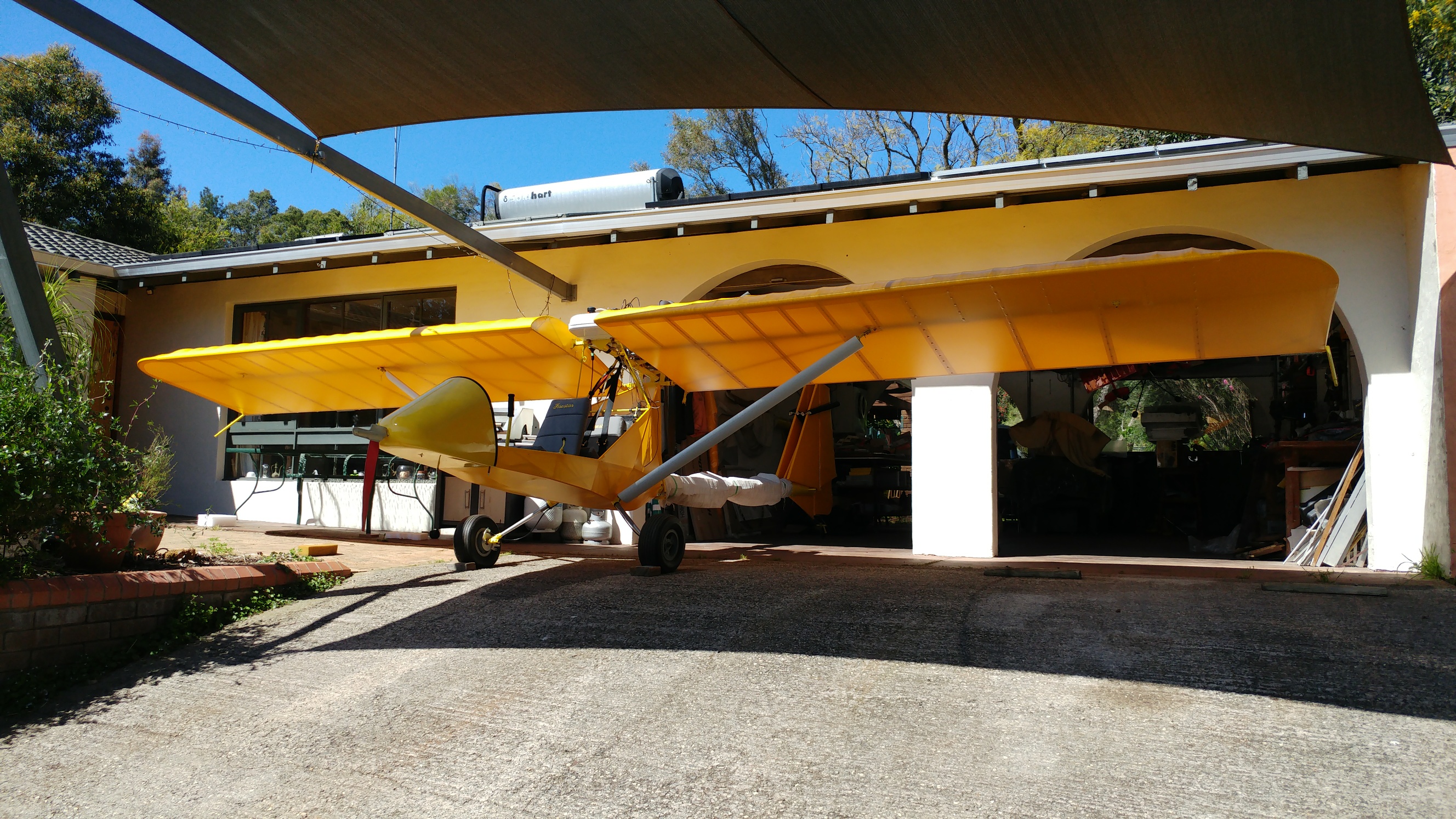

I've covered my Firestar II tandem with Oratex 600 (ultralight fabric) and it is only 9gm/sq ft versus about 20-90gm/sq ft measured by the Oratex dealer in Alaska on other painted fabrics from replaced fabrics, so a significant weight savings.
It is great to use because everything is non-toxic and water based so you can do it in the living room literally with no protective gear! It is a fair amount more expensive than some of the other fabrics, but because it is precoated with uv block and paint, there is a significant savings in painting costs and hassle/work.
The only drawback is that it is not shiny - it has a fine fabric weave, but for the benefits it offers, including patching a hole in about 10 mins with just the application of the water based heat-curing (not hot melt) glue and a hot air gun , you can't beat it - photo attached.
One caution; if you get the unburned fuel-oil mixture on it wipe it off or it could leave a dark brown stain.
Firestar II covered with Oratex 600 fabric.

Brushed on, or sprayed on? Looks great! I did Poly Fiber in my living room with a brush. And not much ventilation. Stunk.
