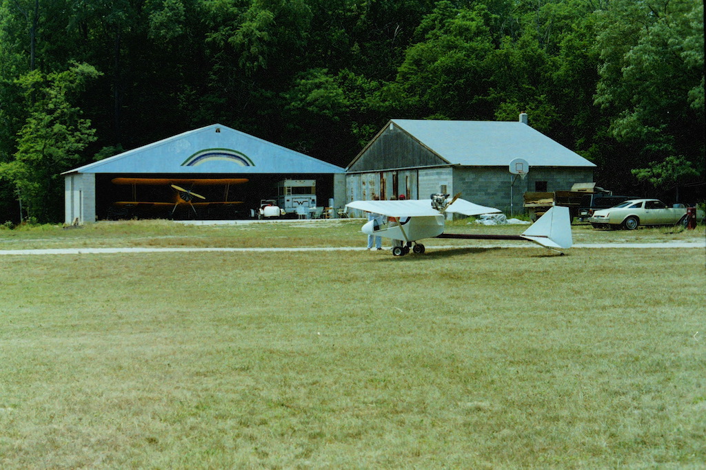

Hello all,I made my first post in a long time a few weeks ago, Here's my second. I'm attaching a photo of my Firestar at a field called Rainbows End in New Jersey in 1987. Lets see if it comes out.
