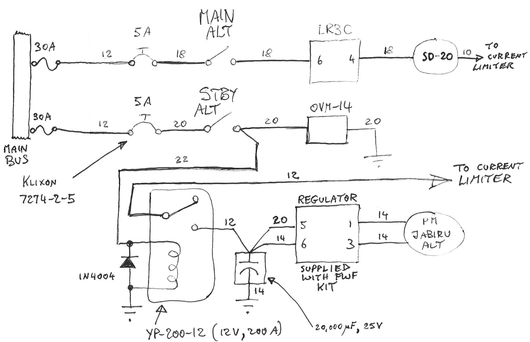

I'm designing the electrical system for my aircraft (a Zenith STOL CH750) based on Z-12 (dual alternator, single battery). The primary alternator is a B&C SD-20 controlled by their LR3C. The stby alt is the PM unit built into the Jabiru 3300 engine, and which is managed by a "kubota" style regulator as supplied with the Jabiru firewall-forward kit.
The LR-3 contains an OV protection mechanism which will protect against the SD-20 going postal, whereas for the stby alt it will be a separate OV Module. In each case the OV protection shorts the supply to ground and trips a 5A CB. Most of the Z figures show a fuselink at the bus, which I presume is to protect the segment of wire between the bus and the circuit breaker.
The Z diagrams show a variety of wire sizes in the OV circuit (for example, Z-20 shows 16, 20, and 22AWG segments all in series) while others (e.g., Z-12) show consistent AWG throughout. I can't figure out why they vary so much, and I'm hoping I can get some feedback on my preliminary design. Here is what I am thinking:
[img]cid:ii_k74bs7mp1[/img]
I sized the main alt wires based on B&C's LR3C wiring diagram which shows 18AWG for the field circuit.
The power wire sizes for the stby alt are taken from Z-20, and the stby control circuit is sized based on the 20AWG wires on the B&C OVM-14 module (and availability of their 24AWG fuselink kit). The relay draws 0.5A.
I'd appreciate any comments.
Thanks.

Hi Pat,
I had the same questions when I first looked at the drawings years ago. There's a good reason for the various wire sizes. 22link to 18wire keeps link size manageable, then the 5A breaker protects the smaller wire.
BTW, you might need to look at the OV circuit. I think that the alt output (regulator out) needs a separate wire to the bus. As drawn, alt output feeds through the 5A breaker. The OV circuit should only connect to the relay coil.

I suggest buying a fuse block that holds 15 or 20 fuses. A builder once said
to install a fuse block that holds twice as many fuses as you anticipate
needing, because you will need them. Every single load, no matter how
small, should have its own unique fuse.
Then replace the fuse-links with 30 amp fuses. Doing that will simplify the
wiring. Looking at Z-20, I suspect the intent was two different wire sizes, with
one a typo. If a 30 amp fuse is used instead of a fuse-link, then I would use 22
AWG for all wires in the field circuit. 22 AWG is good for 7 amps. It takes 40
amps to melt 22 wire.
Charlie, the alternator B lead is separate and not shown on the diagram.

here on the list about 20 years ago who made a really
good buy on a spool of 20AWG Tefzel wire at a garage
sale. He asked if it was okay to wire the whole
airplane with the stuff including circuits that
called for 22AWG.
Of course. Further, as feeders, those wires can
be 'protected' at any level from 7A on down . . .
even 10A would not be a big concern.
Putting a 10A fuse on a 20AWG wire to feed
your gear down indicator lights (1/2A load)
might be 'overkill' . . . but in no way
would it represent increased risk
for an electrically initiated wire-fire.
In some cases there is justification for protecting
feeders at current far more robust than the anticipated,
steady state loads. Consider a 55w landing light
load that draws 4.3A when illuminated . . . and
has an inrush current on the order of 25 amps.
One might be inclined to protect a 20AWG feeder
at 7A. But fuses MELT when overloaded. Further,
if you hit them with a series of transient
'overloads', a succession of short excursions
into 'softening temperatures' will ADD UP to
ultimately reduce the devices previously
calibrated trip point. I would protect a
55W landing light with at least a 10A
fuse.
I'd ignore the 3A fuses and protect your
22AWG feeders with 5A . . . or even
7A fuses if the load normally runs at
say, 4A. Fuses are MUCH faster than circuit
breakers. You want their presence as
defenders of the wire for gross overload
(read: shorts). Seeking to apply the smallest
practical fuse rating based on the devices
being powered is fraught with far more risk
for nuisance trips than risk of setting
your airplane on fire. If anything, you want
a fuse to be rated at 2x or more than load current.
Which brings up another point about using
fuses . . . if you find that one of your
protected loads suffers the occasional nuisance
trip . . . go ahead and upsize the fuse to the
next level. You don't need to upsize the wire.
Had a case like this on my minivan a couple
years ago. Had some shorted turns in the
compressor clutch on the A/C. Normal operating
current rose from about 5A to 6+. The stock
7A fuse would run for a week then blow. The
AC still worked fine. I upsized to 10A and
ran that failing compressor another year
before the increased temperatures in the
clutch coil produced total failure.
Had the thing replaced and went back to
the 7A stock fuse . . . no big deal.
In flight fires and severe smoke are many
times more likely to be based on a fuel or
oil leak . . . not from mis-behaving electrons.
I wouldn't loose any sleep over fuses. When
in doubt, bigger is almost always better
than smaller.

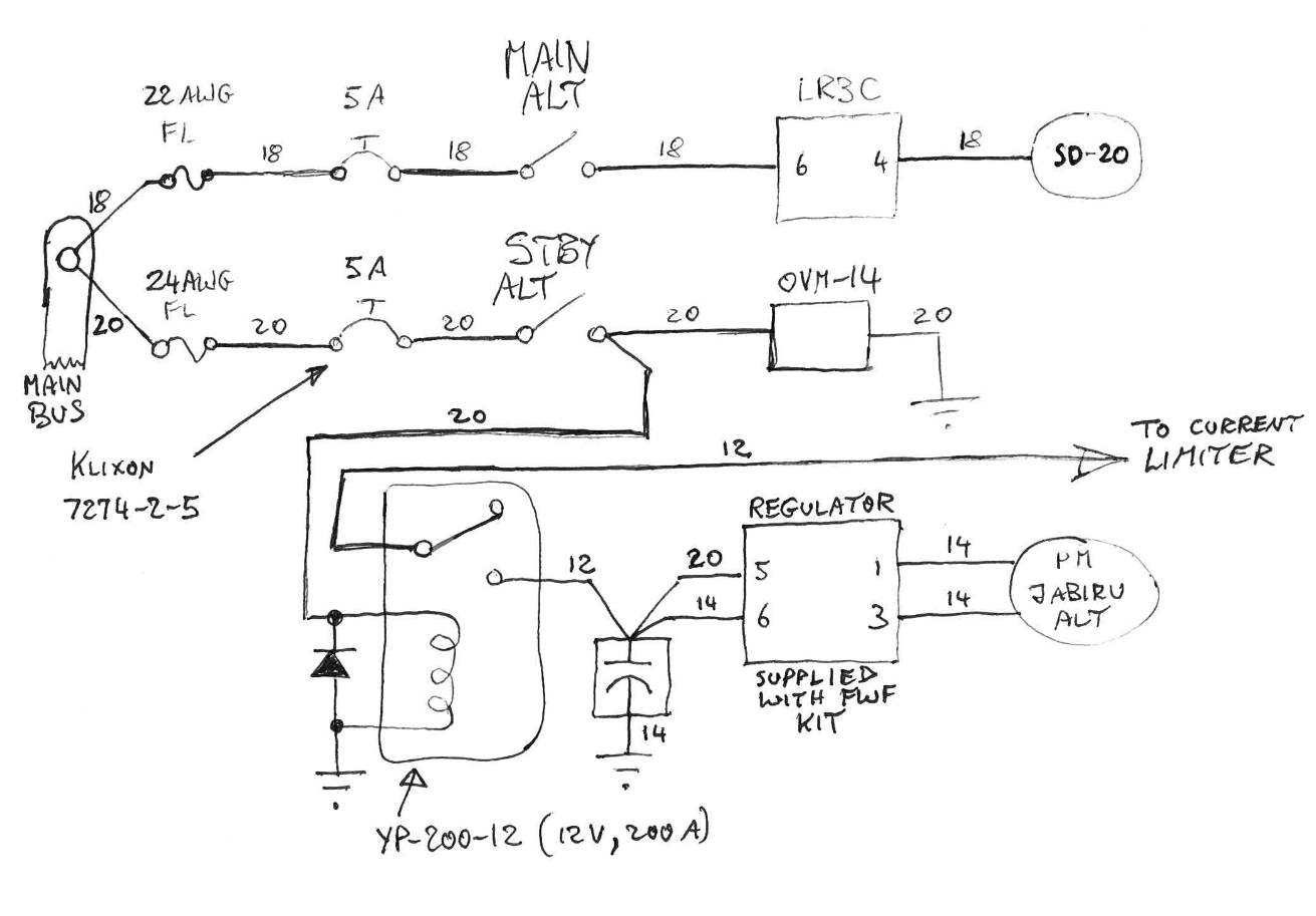

roughleg(at)gmail.com
PostPosted: Tue Mar 03, 2020 6:00 pm    Post subject: OV protection circuit design Reply with quote
On Thu, Feb 27, 2020 at 10:05 AM user9253 <fransew(at)gmail.com (fransew(at)gmail.com)> wrote:
--> AeroElectric-List message posted by: "user9253" <fransew(at)gmail.com (fransew(at)gmail.com)>
Joe Gores
I like the simplification of using fuses instead of fuselinks (my design has 22 fuses so far, another two won't be a problem). And I can appreciate that if an OV occurs, and the CB trips, the fuse needs to be big enough to not also blow and deny the pilot the chance to re-engage the breaker and see if the OV condition repeats itself or not.
But why 30A? That seems very large as compared to a 5A CB.
And a separate thought - if the fuse is significantly bigger, and its sole purpose is to protect the wire between the bus and the CB (am I interpreting this correctly?), then that segment of wire would need to be a lot bigger for the fuse to actually protect it. AC 43.13-1B says a 30A fuse is needed to protect a 10AWG wire - is this a valid reason for having differing wire sizes in different parts of the circuit?
Pat
ceengland7(at)GMail.com
PostPosted: Tue Mar 03, 2020 6:27 pm    Post subject: OV protection circuit design Reply with quote
Joe Gores
Pat
My take is a bit different. I really like fusible links for wires that have near zero risk of failure, short (pardon the pun) of a catastrophic fault. A bit of extra work, once. Then it's more compact (it's just part of the wire run, instead of needing another fuse slot), and no risk whatsoever of extra joints, fatigue failure of the link inside an actual fuse, etc.
Not saying either approach is 'right'; I just prefer mine.
Charlie
PostPosted: Tue Mar 03, 2020 6:41 pm    Post subject: OV protection circuit design Reply with quote
But why 30A? That seems very large as compared to a 5A CB.Â
The I(square)t operating constant for fuses
and breakers of the same RATING are wildly
different. Further, the ATC30 fuse is not
designed to be used as a LIMITER. Hence,
what seems to be overkill is really rather
rational. I've crowbared some 5A breakers that
would trip an upstream ATC20 fuse.
No, we're emulating a LIMITER . . . i.e. mitigation
of a hard fault on the order of hundreds of amps.
Same thing that a fusible link does. Just as
a 22AWG wire has been DEMONSTRATED to carry
20A continuously without damage, so too will
the 14AWG wire gamely step up to continuous
loads of 40A or more.
However, the thing we're holding at bay is
the hard fault that would open the 30A
fuse even if the protected feeder were
a 22AWG wire. In this case our EXPECTED
hard fault is the triggering of a crowbar
SCR which generates a predictable
fault current in excess of 100A.
AC43-13 is a compilation of rules-of-thumb;
it's not a properties of materials nor
engineering text. It doesn't apply here.
PostPosted: Tue Mar 03, 2020 6:42 pm    Post subject: OV protection circuit design Reply with quote
PostPosted: Tue Mar 03, 2020 7:53 pm    Post subject: OV protection circuit design Reply with quote
On Tue, Mar 3, 2020 at 7:47 PM Robert L. Nuckolls, III <nuckolls.bob(at)aeroelectric.com (nuckolls.bob(at)aeroelectric.com)> wrote:
Thanks for the comments. I have revised my drawing - now it looks a lot more like Z-12 preliminary rev NP1
[img]cid:ii_k7cs7jna1[/img]
Pat
 Filesize:  635.76 KB
 Viewed:  12817 Time(s)
user9253
Joined: 28 Mar 2008
Posts: 1978
Location: Riley TWP Michigan
PostPosted: Wed Mar 04, 2020 6:35 am    Post subject: Re: OV protection circuit design Reply with quote
I would not use 12 AWG because it is too big and hard to work with. It
might even damage components that are not designed for large wire.
I would rather use a fuselink, like Charlie said, than use #12 wire.
Electrical circuits require two types of protection, short circuit and
overload. A short circuit occurs when two conductors touch each other.
The current will be very high. An overload occurs when the load draws
more current than it was designed for. Fuses protect against short circuits.
Circuit breakers protect against overloads. Although sometimes only one
type (fuse or breaker) is used to protect a circuit against both types of faults.
In the case of the alternator over-voltage module shorting to ground, we
are dealing with a short circuit. We want the circuit breaker to trip, but not
the fuse to blow. I would have suggested using a 35 or 40 amp fuse if it
would fit into the fuse block, but it won't. Normally we choose the fuse
sized based on the wire size. But in this case, we are not dealing with a
continuous load. We are dealing with a short circuit that only lasts a few
seconds at most. It takes time for a wire to heat up. The circuit breaker
will trip before that happens. Using smaller wire will add resistance to the
circuit, thus helping to limit the maximum current and helping to prevent the
fuse from blowing before the circuit breaker trips. Using 12 AWG wire in this
situation is actually counter productive because the current could be high
enough to both blow the fuse and trip the breaker.
Search the internet for fusing current of wire. It will take over 40 amps
continuous to melt 22 AWG wire. In the time that it takes a 5 amp breaker
to trip, #22 will not even get warm. If 22 AWG wire, between the fuse and
breaker, shorts to ground, the fuse will blow and the wire will not be damaged.
Joe Gores
