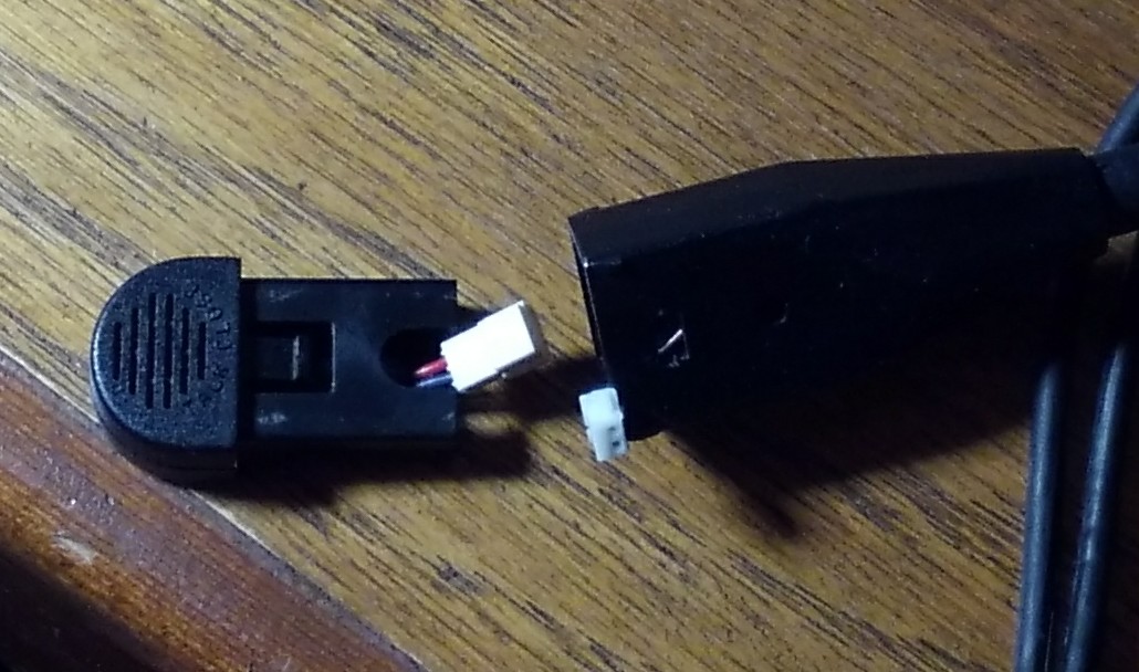

I've got a pair of Telex Echelon's, and the mic has stopped working on them. Even though they're 20 years old, they are in excellent shape other than the mic.
Does anyone know where could I find replacement parts or information on how to repair the mic?

I don't think those mics would work, Charlie. I'm going to try to attach a picture of what I have. I was able to use the online chat to get an email from Telex tech support. The email bounced. [img]cid:88089c2e-5fca-41e1-8fe9-150f4a7e3cfb[/img]

Busting open the mic cartridge reveals this. The tiny mic component has 55DK02 stamped on the side. With o-scope leads across the terminal, I'm not able to get any response by speaking into it.

Well, that's a shame....It's been quite a while since I've bought a new muff style headset (went to Halo-s about 5 years ago, after a decade of love-hate with Lightspeeds). I've never seen the mic set up that way on any of the common makers, from a decade before to a decade after the turn of the century. Everything I've owned (multiple brands) has always used something close (or identical) to the links I sent.
No image this time.
In my obviously limited experience (see the email I just sent), all the
modern headsets I've played with have electret condenser mics that
require DC power to work. Since I've never seen your configuration, I
suppose it's possible that they're using a dynamic mic. Very doubtful
it's a carbon mic, it would probably be a lot bigger.
You might want to plug the headset's mic plug into an active intercom,
and check the little connector for DC bias voltage, both with the mic
connected and without. The DC bias should be there regardless of whether
the mic is connected.
I'd bet that 99.999% of all microphone elements
in common service are of the 'electret' variety.
Easy to make, rugged, can be very small . . . but
this comes with a price.
Special attention needs to be paid to smooth
frequency response and minimize distortion. Qualities
of concern for 'high end' mic manufacturers (studio
quality recordings). Many high-end microphones
still exploit legacy technologies to achieve
the desired performance.
But the great unwashed, 'communications
grade' microphones will use this technology.
https://tinyurl.com/k59r249
These critters need to be biased at something
on the order of 2-4 volts. In aircraft microphones,
getting this bias is no big deal . . . aircraft
audio systems EXPECT a carbon microphone analog,
their design includes a bias network to supply
voltage to the microphone.
So your experiment to exercise the microphone
while observing output on a 'scope would
not yield useful information unless you
implement the necessary external bias
supply.
