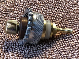

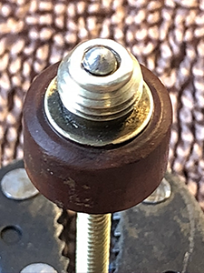

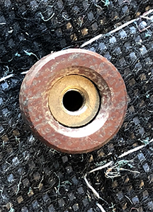

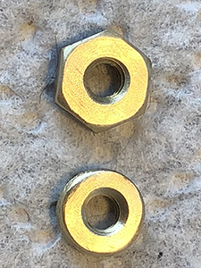

Gents,
I ordered two of Richard’s mag coils a while ago. Lovely workmanship and quality. Highly recommend.
After taking apart the mags to install the coils, my mechanic told me that for the timing, there is an easier way to connect the alligator clips from the E-50 buzz box that does not involve taking the rotor cap off.
Using an extra set of P-lead connectors (George Coy has these), it’s possible to make a simple adaptor using a 6-32 brass nut, a 2-inch 6-32 brass machine screw with the head cut off and some teflon spacers. Attached are some images. Here are the steps and some images.
1. Drill (7/64) and tap the metal center of the phenolic connector for a 6-32 thread.
2. Grind down a 6-32 brass nut so it’s a snug fit inside the the phenolic connector. This adds support for the machine screw.
3. Tin just the tip of a 2-inch 6-32 brass machine screw with the head cut off. Be careful not to damage the threads.
4. Add the brass nut. Assemble and advance the 6-32 brass screw down to the end of the metal tip.
6. Solder the tip of the brass screw in place.
7. Screw on the P-lead cap.
8. Place 1-2 mm of heat shrink tubing to the machine screw just above the brass nut.
9. Grind down some teflon washers so they fit securely inside the brass sleeve. Enough if these are needed so they extend several mm beyond the top of the brass sleeve.
10. A washer and nut secures everything tightly. The alligator clip attaches to the protruding machine screw.
Screwing one of these into the P-lead hole of each mag now allows you to check the timing without taking off the rotor cap. An adaptor like this should last forever.

PostPosted: Tue Apr 28, 2020 8:32 am    Post subject: Mag timing Reply with quote
That’s all well and good, except;One - you can not verify the point gap without removing the mag cap. And the point gap directly affects the timing. And you can not check the wear on the point foot either. The foot wear (mostly because the oil wick is dry or worn to the point where it is not rubbing on the point cam) will cause the point gap to change. Ultimately to the point where the mag goes dead because the points won’t open.
Secondly, without removing the mag cap you can not “fine tune” the mag timing which includes easily synchronizing the mags.
Third, and this is something many people ignore; unless you remove the mag cap you can not check the “E gap” which is aligning the rotor finger to the scribe mark on the mag cover surface precisely when the points open.
These are the steps required when you check the timing which I don’t believe you can do without removing the mag cover and distributor cap.

PostPosted: Tue Apr 28, 2020 11:53 am    Post subject: Mag timing Reply with quote
All good points Dennis.
Warren

PostPosted: Tue Apr 28, 2020 3:18 pm    Post subject: Mag timing Reply with quote
Hey guys.
All of you guys need to screen shot the info below and put that in your technical data folder for condition inspections.  It doesn’t get any clearer than that.
If Dennis was one of the X-Men.   He would be Mr Magneto.

> On Apr 28, 2020, at 10:40 AM, Warren Hill <k7wx(at)earthlink.net
> <mailto:k7wx(at)earthlink.net>> wrote:
> Gents,
> some images.
> Warren Hill
> N464TW
> Mesa, AZ
> <nut.png>
> <support.png>

> On Apr 28, 2020, at 10:40 AM, Warren Hill <k7wx(at)earthlink.net> wrote:
> Gents,
> cap off.
> for a 6-32 thread.
> Warren Hill
> N464TW
> Mesa, AZ
> <nut.png>
> <support.png>
> <tip.png>
> <Assembled.png>
