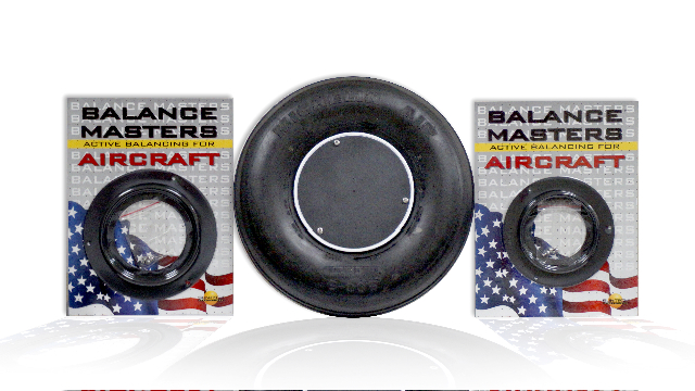

BTW, I am/was also exploring using the "Balance Masters" Cleveland wheel balance ring (http://www.balancemasters.com/aircraft.html) - not the prop stuff. I will report back when/if I actually install it. FYI - the owner of Balance Masters is a pilot and a great guy to talk to!
