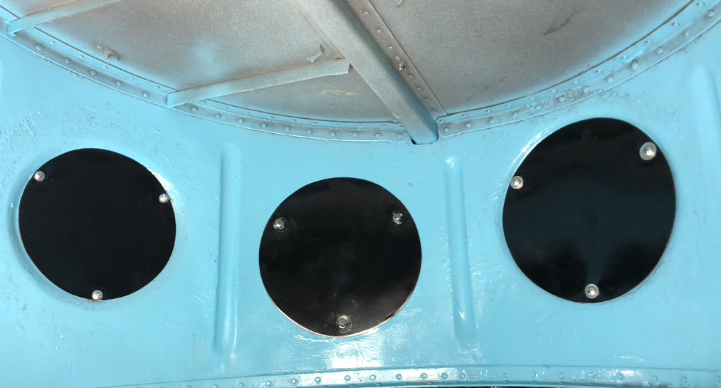

PostPosted: Wed Jul 15, 2020 10:28 am    Post subject: Wheel Well Fabric Redo Reply with quote
This is what Craig Payne’s painted wheel well covers look like when installed. They fit perfectly.
Warren Hill
