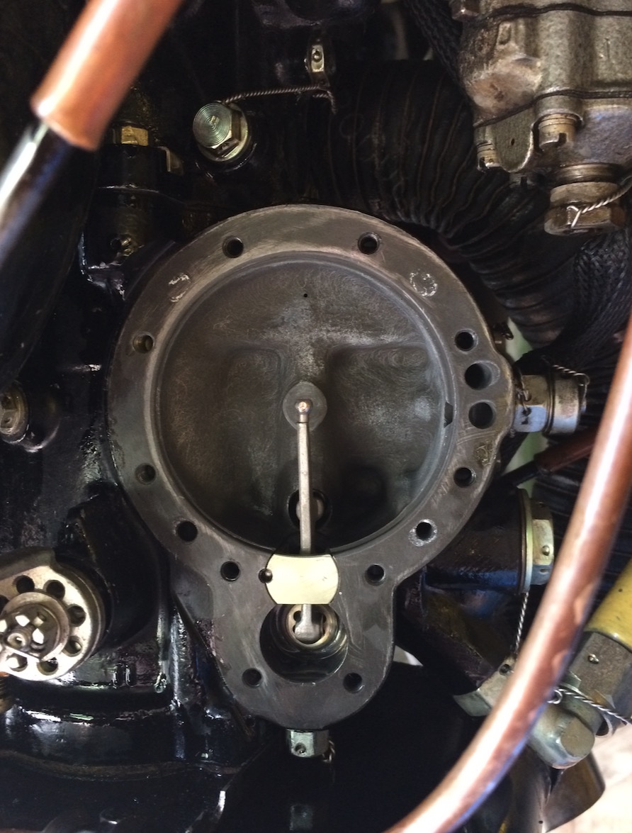

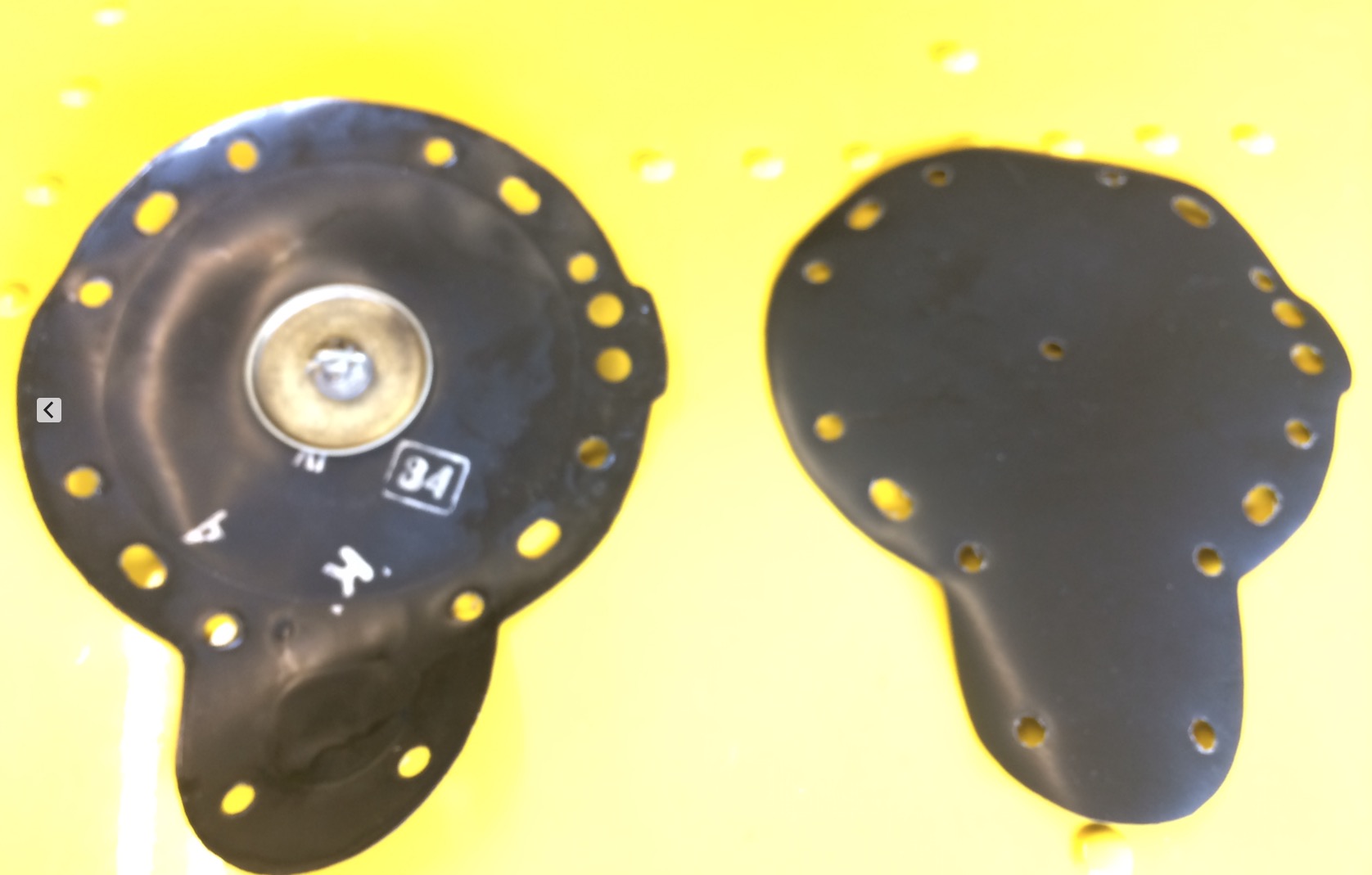

PostPosted: Mon Aug 10, 2020 9:25 pm    Post subject: Re: Carb and fuel pump membrane replacement Reply with quote
The membrane also seals the carb cover. Its a flat piece of rubber with cotton net inside.
Install it without any stress on the screw holes. Flat and even. Watch for the "hook" when installing/removing it.

PostPosted: Tue Aug 11, 2020 7:34 am    Post subject: Carb and fuel pump membrane replacement Reply with quote
Thank you for the photos of the membrane showing the "hook".  I recently purchased the two membranes for my carb on my M14P and that is on the winter maintenance list for 2020.
My membrane did not come with the hook shown in your photos.  I assume that the hook is transferred from the old membrane to the new one.?
I also plan to replace the membrane on the top of the carb as well.

PostPosted: Tue Aug 11, 2020 7:52 am    Post subject: Re: Carb and fuel pump membrane replacement Reply with quote
Yes, you do reuse nuts&washers which are in the old membrane. You need a new cotter pin.
The case cover might be a bit hard (sticky) to remove, pry it only a little. You need to unhook it from the rest before you can remove it.
Remember the orientation of the hook assembly. The membrane has plenty of holes, make sure is the right side when installing.
Securing everything with safety wire afterwards is a bit tight & challenging.

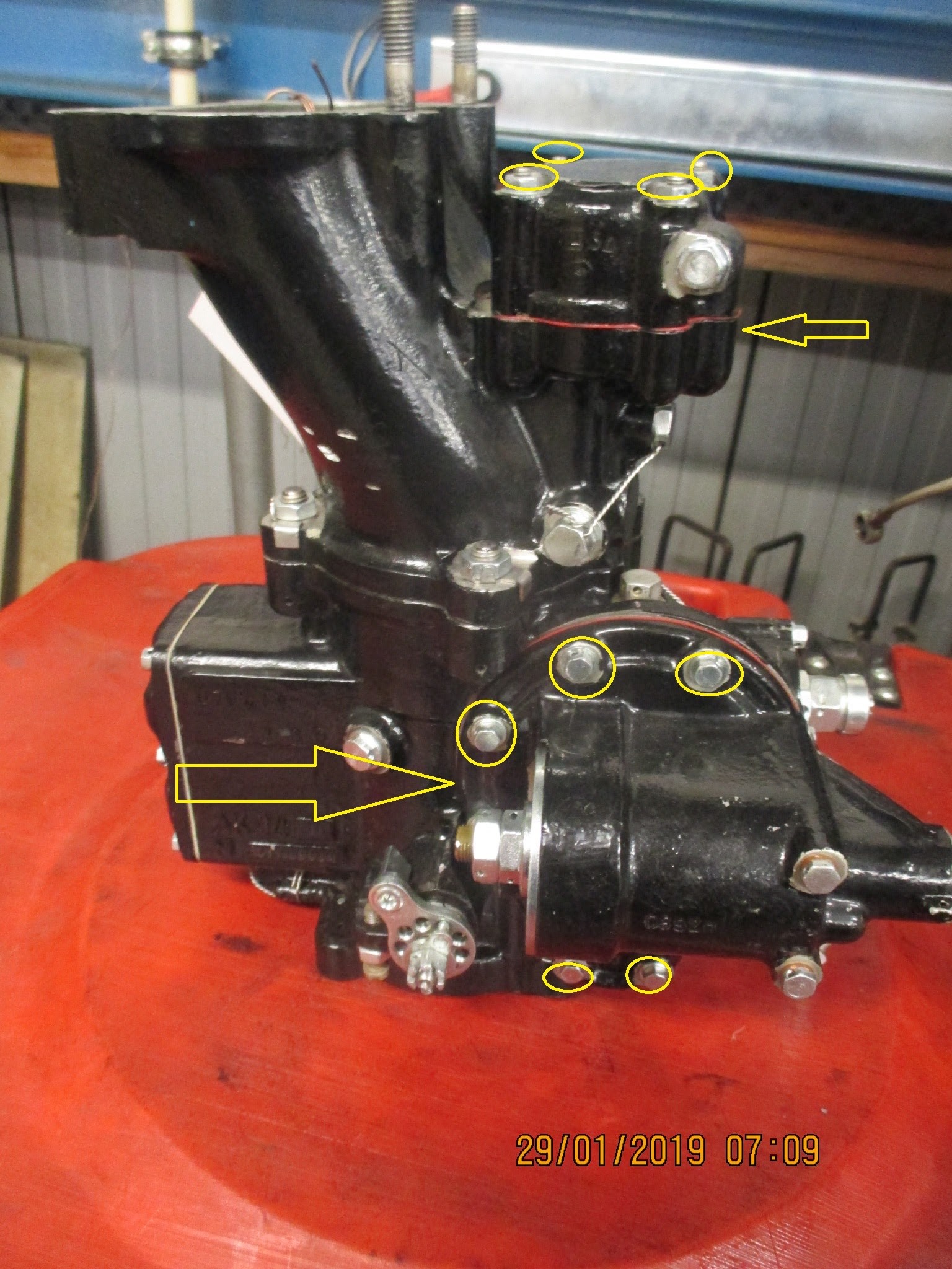

I have attached a photo showing the position of both membranes.
Thanks you again for the info.  👍

pennington.construction.i
PostPosted: Tue Aug 11, 2020 8:44 am    Post subject: Carb and fuel pump membrane replacement Reply with quote
I forgot to give credit for the attached photo.
The photo was sent out by Richard Goode showing the position and what needs to be removed for each membrane.
Thank you Richard.  👍
