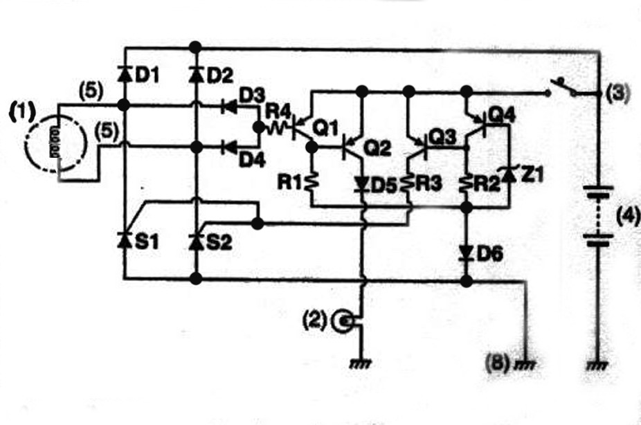

The 'voltage regulator' under discussion is
a rectifier/regulator assembly used in
conjunction with a permanent magnet
alternator. Exemplar schematic attached.

PostPosted: Thu Aug 13, 2020 6:23 am    Post subject: Valid test for voltage regulator Reply with quote
The email is probably spam, but I still found the diagram useful.
I got the test rig set up last night and ran it with no more load than the meter on it. My lathe has a VFD, so I can read the RPM from a digital readout. What I got was:
457rpm -> 14.6V
623rpm -> 14.64V
897rpm -> 15.09V
991rpm -> 15.7V
I'll hook a battery or a couple lights to it later today to see if the regulator needs a significant current flowing to regulate properly, but it doesn't look to me like this regulator is regulating very well.

PostPosted: Thu Aug 13, 2020 9:42 am    Post subject: Valid test for voltage regulator Reply with quote
457rpm -> 14.6V
623rpm -> 14.64V
897rpm -> 15.09V
991rpm -> 15.7V
Contemporary PM R/R needs a load to be optimally accurate/stable.
How do the rpms in your test data relate to engine rpms in
operation?
It will settle down with a load.

PostPosted: Thu Aug 13, 2020 10:48 am    Post subject: Valid test for voltage regulator Reply with quote
The engine idles around 650. Max RPM is 3,000.

PostPosted: Thu Aug 13, 2020 11:05 am    Post subject: Valid test for voltage regulator Reply with quote
Is the alternator concentric on the crank (VW style), or belt driven? If belt, what's the *alternator* rpm range?

PostPosted: Thu Aug 13, 2020 11:21 am    Post subject: Valid test for voltage regulator Reply with quote
It's concentric. Bolts up in place of the harmonic dampener on a Corvair.
