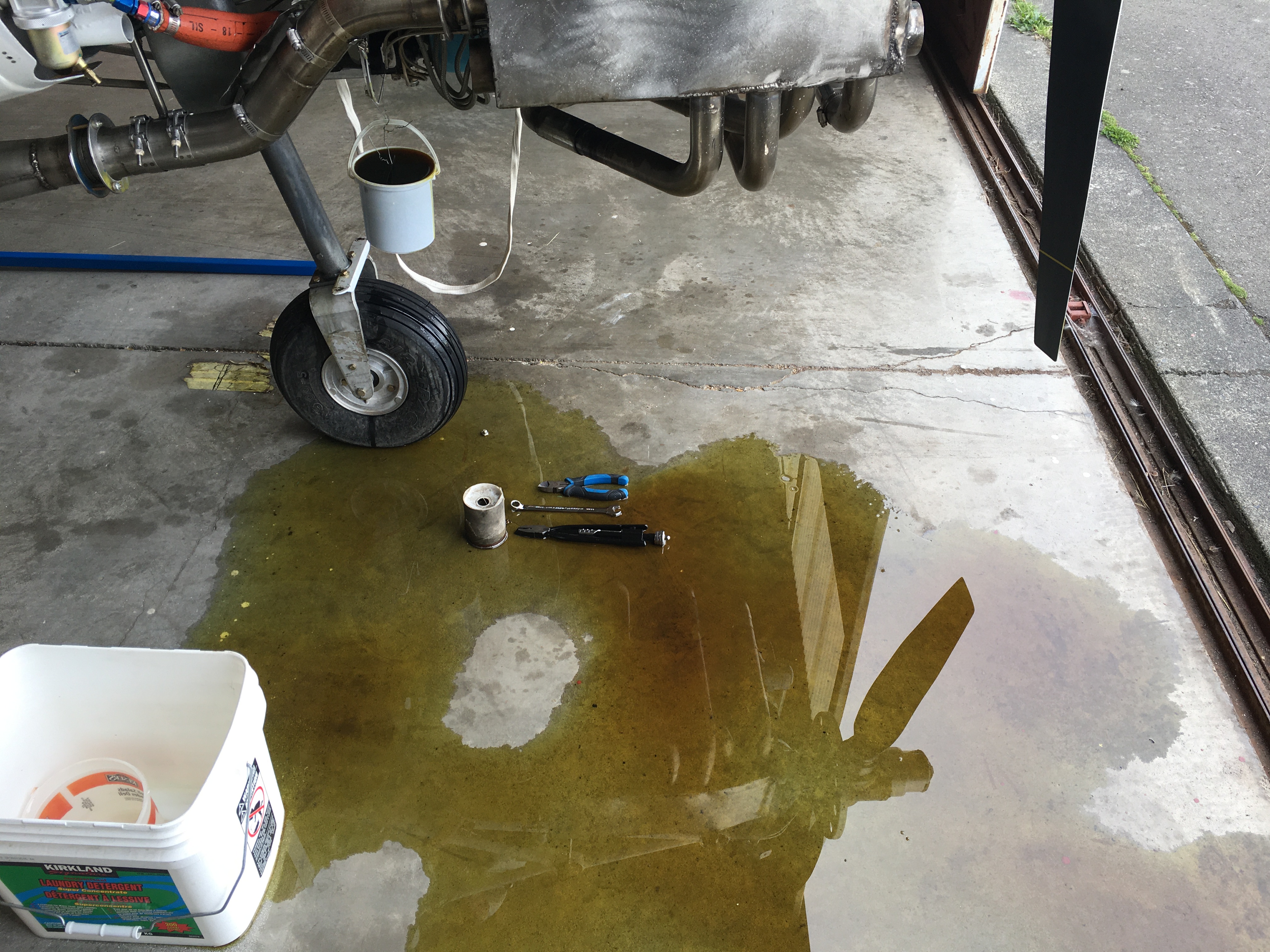

PostPosted: Sun Aug 23, 2020 6:33 pm    Post subject: Fuel Mixture Reply with quote
Hello Steve,
I drained the oil from the fuel pump. I removed the plug and oil came out very slowly so I left it overnight. Fortunately I put a small container under the drain hole as this morning I found that about 3 pints had drained out.
I cannot imagine where there is room for that amount of oil. Could it be that my scavenge pump is not doing it’s job?
Have not tried to start it again but will let you know
Mike

PostPosted: Sun Aug 23, 2020 6:57 pm    Post subject: Fuel Mixture Reply with quote
Three pints seems impossible. Did you drain that from the pump, or from the screen at the rear of the camshaft housing? Steve-- Stephen BeaverTel: 614-937 4189

mike(at)vision499.com
PostPosted: Sun Aug 23, 2020 8:06 pm    Post subject: Fuel Mixture Reply with quote
Hello Steve
I also thought it was impossible, I drained it from a small plug at the bottom of the fuel pump, the plug only needs a 12mm wrench so is small. Working forward from the rear of the pump there is a small slotted screw and then the plug. These are the only fittings on the bottom of the fuel pump. I can see a large nut on the camshaft cover that I assumed to be the drain under the scavenge pump, I did not open that. Could this oil have siphoned from somewhere?
Thanks for you help
Mike

That is a surprising amount of oil. In a normally functioning, current revision engine I would expect to see perhaps a table spoon of oil. In the older style pump with a filler port on the side, perhaps a cup. Then again I have never left the pump open overnight. There is a connection from the engine oil system to the pump in that one of the factors the pump uses to set the fuel mixture is oil pressure.
I would suggest proceeding as follows:
1. Remove the drain plug/screen under the scavenge pump. How much oil do you see there? If you see a a cup or more then I would suggest all is well. If you see almost none then it would appear that the cam case oil is somehow leaking into the injection pump. This seems unlikely though
2. Put everything back together and run the engine. Asses the performance per my previous email and then remove the oil drain plug in the pump again. How much oil this time? (Use something more scientific than the hangar floor to measure it Smile ) Steve-- Stephen BeaverTel: 614-937 4189

Hello Steve

Hello Steve,

Mike.
There are no o-rings in the fuel inject system to be concerned about and I would suggest that you do not disassemble it. It is a complex and very precise device! - What you might do, however, is remove the drain plug on the underside of the unit and allow any accumulated oil to drain out. If sitting for a long time excess oil can accumulate in the pump and interfere with the mixture.
Let me run through some of the other items you might check. I am not implying that there is any part of the manual you have not digested. Just making sure I don't omit anything Smile
First and foremost (If I had a $ for every time I explain this . . . ) is the automatic mixture system. People used to operating American engines seem to think that the engine should always be operated at the most rich setting available. That is just not the case with the LOM and doing so so will have serval rather bad consequences.
Look closely at the mixture control arm that extends from the side of the fuel injection pump. There is a slot in the arm, inside of which is a small pointer. Also on the side of the pump is a shiny metal plate shaped like a pizza slice on which are marked the mixture settings. Something like +3, +2, +1, N, -1, -2 with the -2 being nearest the top. Adjust your mixture control mechanism so that the "normal" (all phases of operation below 10,000') corresponds to the pointer being aligned with the 'N' mark. - Actually 'N' inside a circle. Now you know the mixture is set exactly as it should be. Again - do not operate the engine at the full rich setting. Doing so will disable the automatic mixture system, foul the plugs, wash lubricant from the cylinder walls and other bad things.
Next, start the engine and let it warm up for an extended period. When the oil temp is up in the 100F area, carefully and with the appropriate precautions run the engine at full power (super charger engaged) Switch from both to magneto 1. What RPM drop do you see? Go back to both, then magneto 2. Again, what RPM drop do you see? I would expect a drop in the 25-35 RPM area. Anything other than that suggests your ignition timing is a little out. It is a simple matter to loosen the magneto clamps and rotate the mags a little until the 25-35 RPM drop is observed. Why not just time the mags with a buzz box in the traditional manner? For two reasons: 1) This is how the manual says to do it and 2) these magnetos have automatic advance and retard systems so static timing means almost nothing.
How that the mixture and the ignition timing are up to snuff, you can do some testing. Operate the engine for as long as is reasonable at a cruise sort of power setting. Say 25" of manifold pressure. (It doesn't matter if the super charger is engaged or not). Now shut down and observe the exhaust pipes. Are they back and sooty, a very light gray (almost white) or a nice mid gray, the color of a slate roof? - We want the slate color.
If in doubt, remove the spark plugs and see what they look like.
Another useful trick (if you have straight pipes) is to run the engine in the dark and look into the exhaust pipes of the running engine. At medium power settings look for a nice blue flame tinged with yellow to indicate the ideal running conditions.
Finally, since I see you are in BC, you could contact Pavol Novak who now resides at Qualcom Beach on Victoria Island. He is a Czech LOM factory trained technician and expert on the engines (and Zlin airframes)

PostPosted: Sun Sep 06, 2020 3:28 pm    Post subject: Fuel Mixture Reply with quote
Hello
I have been away for a while but back now.
I drained the sump on the Cam Cover and there was about a cup of oil.
There is a large plug on the side of the fuel pump and I assumed that this is the level  the oil is supposed to be that is mentioned in the manual. I filled the fuel pump to this level and it took about ¼ cup or +/- 60ml
When I tried to start the engine there is now nothing, not even a “poof” or even one firing on the primer fuel.  I tested for spark and that seems to be OK, and I can hear the Slickstart buzzing when I power it up
I removed all the plugs and fuel injector nozzles, I fitted a nut to one of the nozzles and rotated the prop by hand, I got one squirt of gas out of the nozzle but after that I only saw drops forming at the tip of the nozzle.
Is the return oil line that runs from the fuel pump to the sump equipped with a one way valve? I thought of running oil into the fuel pump and then checking if oil runs out of the sump plug cam case plug. Not sure if there is a direct connection, but there must be something that stops the cam case oil draining into the fuel pump.
The deposits at the rear of the exhaust manifold is darkish gray

PostPosted: Mon Sep 07, 2020 11:39 am    Post subject: Fuel Mixture Reply with quote
Mike,
Those are interesting results! You appear to have the older style pump and you are correct that it should be serviced with engine oil up to the level of the filler plugs.
If there is a spark (at about the correct time) and the primer is delivering fuel then it is hard to understand why it didn't fire to some extent. Could it have been flooded? Inverted engines are rather prone to flooding. You can try clearing the engine out by propping it backwards, but waiting for 20 minutes and trying again with the throttle about half way open is usually best.
I am confused by your reference to the "return oil line from the fuel pump". There should be three connections to the pump: fuel inlet, fuel return and fuel pressure. Older pumps may also have a hose nipple on the side to vent the oil system. This is usually connected to small hose running upwards above the level of the and is open at the top. Steve-- Stephen BeaverTel: 614-937 4189

PostPosted: Mon Sep 07, 2020 2:01 pm    Post subject: Fuel Mixture Reply with quote
Thank you very much, I think it was flooded and then I took the spark plugs out and blew compressed air through the plug holes. When I tried again I might have been wary of flooding it again and did not prime enough. Will try again to-morrow.
Is there an easy way to check ignition timing?
When I mentioned the "return oil line from the fuel pump" I was referring to the oil passages that I presume run through the mounting flange between the fuel pump and the cam shaft sump. One to supply oil and one to drain.
Will let you know what happens to-morrow
Thanks again
Mike
Steve

Hello
Would appreciate you suggestions.
Mike
Steve

Hello Steve
Thanks for you help
Mike
Steve

Hello Steve,
Mike

Mike.
Steve

PostPosted: Thu Sep 10, 2020 12:18 pm    Post subject: Fuel Mixture Reply with quote
The method to check ignition timing is pretty simple. Run the engine at maximum RPM and test each mag. You should see a drop of 25 RPM. If not, adjust the mags as necessary to get that. Advancing the timing will give a smaller drop, retarding it a larger one (I think)
There can be no "one-way valve" because no oil actually flows anywhere. The pump is just sensing oil pressure. Steve-- Stephen BeaverTel: 614-937 4189
On Sep 7, 2020, at 6:00 PM, mike(at)vision499.com (mike(at)vision499.com) wrote:

Mike,

Hello
Mike
From: owner-lom-list-server(at)matronics.com (owner-lom-list-server(at)matronics.com) <owner-lom-list-server(at)matronics.com (owner-lom-list-server(at)matronics.com)> On Behalf Of sjbeaverSent: August 24, 2020 5:08 AMTo: lom-list(at)matronics.com (lom-list(at)matronics.com)Subject: Re: Fuel Mixture

Hello Steve
Thanks for you help

Hello Steve,

Mike.

Thanks again for your help, got my engine started and will check oil level in fuel pump again when I have run it again.
I cannot visualise what the oil does in the fuel pump. I have model 5151.03 and the manual mentions oil in through pressure reducing valve (29)
with the level controlled by a drain hole (31) and out to the scavenge pump  (32) You  say "The pump is just sensing oil pressure"
May I ask you to explain again.
