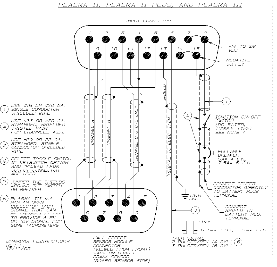

[img]cid:ii_kffwu5010[/img]
From the Lightspeed installation manual. I was working toward improving on the factory recommendation in this document. While a fusible link won't be as fast as a fuse, it seems better than a 5 or 6 foot long always hot wire to the CB.
Charlie
On Wed, Sep 23, 2020 at 3:26 PM Robert L. Nuckolls, III <nuckolls.bob(at)aeroelectric.com (nuckolls.bob(at)aeroelectric.com)> wrote:
To protect the wire itself, I like using fusible links. For light consumers like the ignitions, a few inches of 22ga wire at the battery bus (sleeved with a fiberglass jacket) soldered to 18ga wire feeding the switch/ignition will protect the always-hot section of wire from catastrophic faults.
  but doesn't satisfy the crash safety condition
  Fusible links are generally limited to use in
  areas protected by battery master but included
  to isolate hard-faulted feeders from the remainder
  of normally functioning distribution.
  The battery bus should (1) drive fuse or breaker
  protected feeders at 7A or smaller -OR- if protection
  is larger, then a relay at the bus to manage that
  feeder's crash safety recommendations.

PostPosted: Thu Sep 24, 2020 5:49 am    Post subject: Z13-8 modification and LSE ignition wiring Reply with quote
I use dual Lightspeeds in my Cozy. Direct feed off the batteries forward about 8’ to the switches and back to the LSE boxes in back. Of course, the wire is in a non-conductive composite airplane but I do not worry about the wire shorting in a crash. There is no telling what can happen in a crash. Maybe the battery gets ripped loose in a hard crash and shorts on your airframe or part of the metal in the airframe crushes on the battery and creates a dead short. I suppose the idea for a fusible link is OK but 4 wire-sizes smaller than the 18 awg shielded wire Klaus recommends is pretty small wire. I would rather have the more robust, continuous wire with no solder joints and shrink-wrap, install it carefully, protected against rubs and vibration.
-Kent
