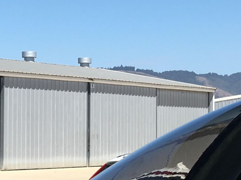

Here's a picture looking out of my hangar, from just outside the airplane:
[img]cid:ii_kh2chgdm2[/img]

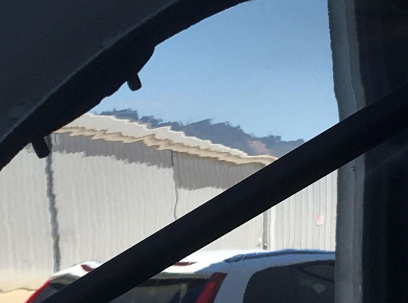

Here's the same view looking through the new windshield:
[img]cid:ii_kh2ckfx81[/img]
Somehow it seems worse in the picture than in flight, although I do see things kind of jump around as they pass the distorted area.  Certainly not acceptable.
The first thing I did when the replacement arrived was to take the plastic off and check it.  The difference is night and day.  The replacement is basically perfect.
