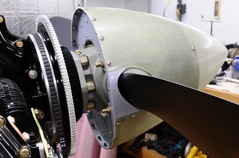

Dear Listers,
I've got this Propeller wrench from Avery:
http://www.averytools.com/p-734-hartzell-style-propeller-wrench.aspx
But what is the multiplier for the torque conversion when using this extension on a standard 1/2" drive torque wrench?
One other question, on those hartzell prop bolts, do you run a safety wire though those rollpins pins in the bolt heads?

I can't remember the conversion and I am sure that someone else will answer
that before I can get to my hangar and look at my torque wrench that has the
conversion in the box. I can say yes you do safety wire the bolts. Alxo it
looks like the piece you made behind the prop cut out in the spinner is very
close to the prop. You should be very carefull with that as the4 prop will
flex backwards and will wear if the spinner filler is too close. Both Dan C
and I had this problem. Don

ditto on the spinner clearance. The view shown will definitley cut te prop. (happened to me). I cut the filler plate all the way back to the backing plate to achieve sufficent clearance, and it was just enough.
I am 99% certain the safety wire passes thru the roll pins.
Dick
