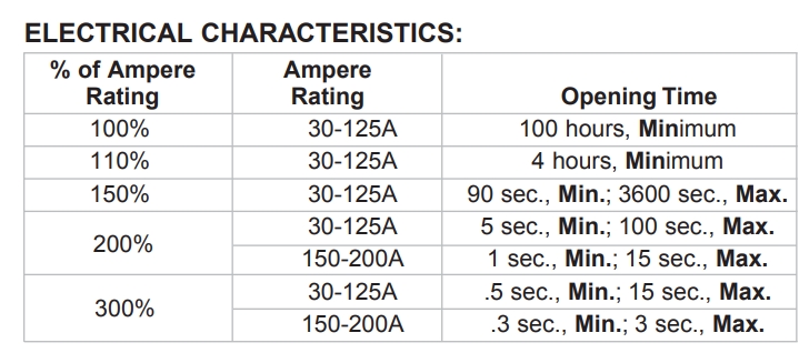

Unlike CIRCUIT BREAKERS . . .
ANL (vintage) or MIDI/MANL (recommended) devices
are CURRENT LIMITERS. Check out the specs
https://tinyurl.com/by5qnop
a CURRENT LIMITER is intended to clear
hard faults (read: more amps than you'd
like to have flowing anywhere on the
airplane!).
A current limiter will typically
carry it's rated current for a very
long time.
[img]cid:.0[/img]
150% of rating is still longer than you
want a branch circuit protection to trip.
But hit say a MIDI50 with 500A (1000%) fault
and it's going to open in about 100 milliseconds.
Short story, when purchasing current limiters,
the size equal to your expected continuous
current is fine . . .
CIRCUIT BREAKERS are another story . . . and
not recommended for alternator b-lead protection
anyhow. Beech quit putting them into the b-leads
about 3 or 4 decades ago . . .
