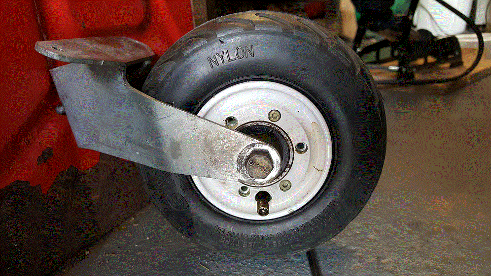

The lighter wheel shown at:
https://www.ebay.co.uk/itm/6-X-2-Inch-Air-Wheel-Tube-Pneumatic-For-Electric-Scooter-Wheel-Tyre-Tires/383724699433?_trkparms=aid%3D1110006%26algo%3DHOMESPLICE.SIM%26ao%3D1%26asc%3D229886%26meid%3D60f0083d1c0c4c44bc214523a4739057%26pid%3D100005%26rk%3D1%26rkt%3D12%26mehot%3Dco%26sd%3D303733012883%26itm%3D383724699433%26pmt%3D1%26noa%3D0%26pg%3D2047675%26algv%3DSimplAMLv5PairwiseWebWithBBEV2bDemotionHighArwV3%26brand%3DUnbranded&_trksid=p2047675.c100005.m1851
saves about 1lb in weight against the original solid-tyred wheel. But the hub bearing takes a 8mm bolt rather than the Factory 3/8".
Otherwise, the tyre and tube for that wheel are available separately and will fit the original (Classic) tailwheel hub, which in turn will then fit the XS tailwheel fork; photo attached.
However, the rather 'robust' original rim wipes out half of the weight saving!
Duncan Mcf.
