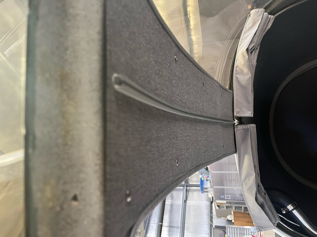

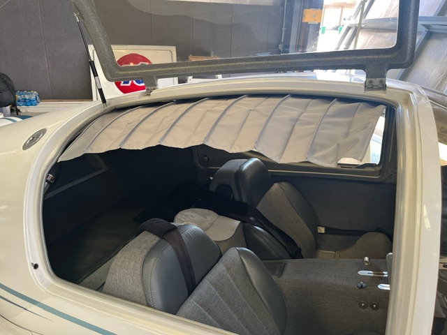

Having recently received an inquiry on the sunshade I installed on my Europa I thought I would share the following. The shade is made by Koger in the USA. I noted that his website list the Europa as using a “universal small”, which I feel is too small. The “universal large” would work if you don’t mind a taper in the front. He offers custom shades, which is what I purchased. It’s the same dimensions as the large, but without the taper.
I mounted the center rail to ceiling panel using small screws. The rail needed some bending to conform to the curvature of the ceiling. Not a big deal, just take your time. Lastly, I did not glue the fabric panels to the ribs. This allows me to slide the panels down the side of the window providing better coverage when the sun is low in the sky. I am very pleased with the shade.
