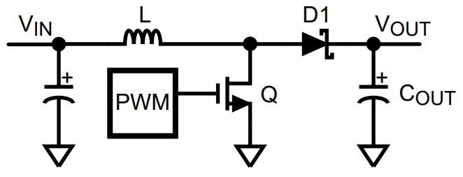

I'm starting to sneak up on wiring my Kitfox project, so I've been looking over Z101 in detail. Take a look at this idea to simplify the Brown-Out Booster and AUX BUS Normal Feed path, and tell me if I'm out to lunch:
Z101, for reference: https://tinyurl.com/1120mgeh
1. Delete the AUX BUS normal feed path from the bridge rectifier.
2. Remove the Brown-Out Booster input feed from the Engine Start pushbutton switch, and instead connect it directly to the Battery Contactor with a short-as-practical 14AWG wire.
3. Remove the output of the Brown-Out Booster from the normally-closed contact of the AUX BUS Alternate Feed Relay, and instead connect it to the AUX BUS normal feed point that was previously supplied by the bridge rectifier, again with a short-as-practical 14AWG wire.
Since the DC-to-DC boost topology (see attached image) offers no barrier to forward current flow, it can pass normal feed current for the AUX BUS even when it isn't needed for boost duty. Its rectifier will prevent backfeed from the AUX BUS to the MAIN BUS in the event that the AUX BUS Alternate Feed Relay is closed. If the Brown-Out Booster's output is set to 12V, then its controller IC will simply stop switching any time its output voltage exceeds that value. During engine start, the controller IC will already be "awake" and will start switching the instant its input sags to one diode drop above 12V.
A few issues that I'm still mulling over:
1. This proposal assumes that the Brown-Out Booster is tested to ensure that its inductor and rectifier can continuously pass full running current for the AUX BUS, and any later additions to the AUX BUS will have to be considered with this limitation in mind.
2. Is it acceptable -- or even a good idea -- to connect a Brown-Out Booster directly to the Battery Contactor with no fuse, as if it were integral to the AUX BUS?
3. If the answer to #2 is no, then does it make sense to fuse the Brown-Out Booster/AUX BUS Normal Feed, and if so, at what value? This is complicated by the fact that Booster input current increases faster than output current, and it also increases as input voltage decreases.
Thoughts?

Eric, what advantage does your proposal have over Z-101?
Why eliminate the normal diode feed path to the aux bus?
You can rewire the brownout booster whether the diode is there or not.
It is a bad idea to have two fuses in series. Z-101 does not fuse the aux bus.
Is a brown out booster really necessary? Doesn't your EFIS have an internal backup battery?
My radio recovers in a few seconds after engine cranking.
My transponder takes longer to establish its GPS location. But so what?
Why even supply a whole bus with brownout protection?
Why is a separate aux bus needed?
Just connect one or two loads to a brownout booster using dual diodes.

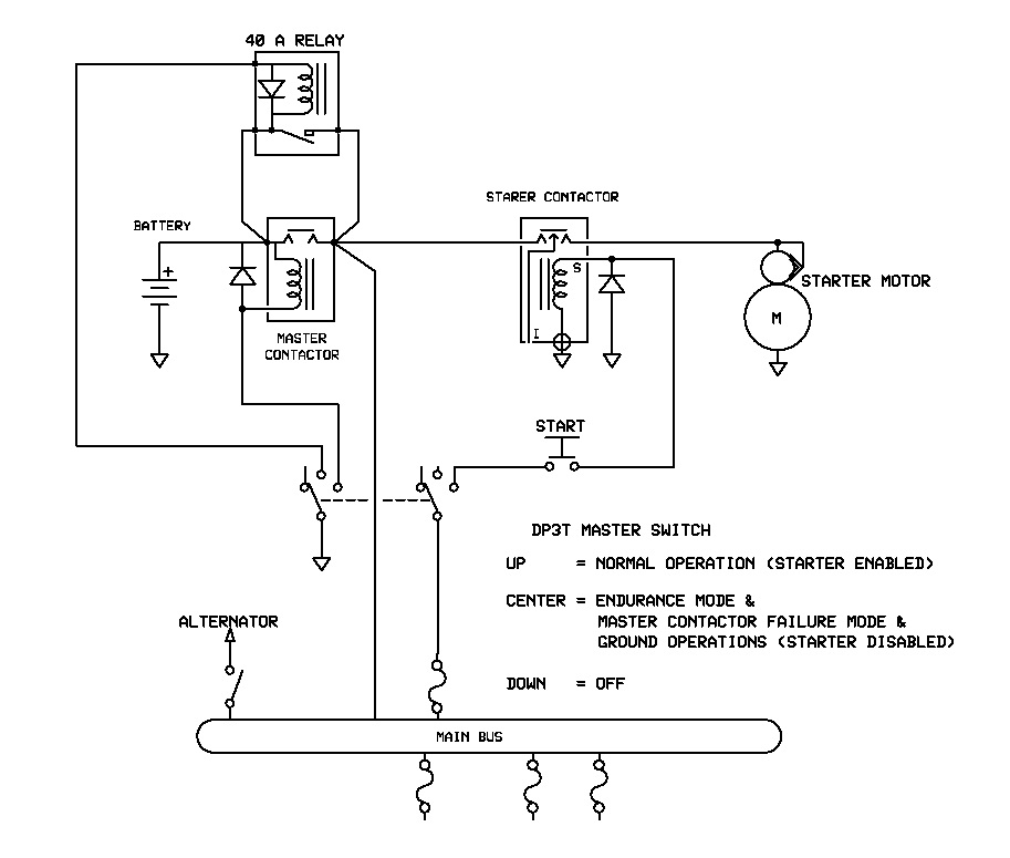

Consider the attached electrical drawing. Just the relay can be energized for ground operations.
In the unlikely event that the main contactor fails in flight, the relay can be energized.
With a single bus, there is no need to remember what loads are on what bus.
If it is desired to conserve the battery, just shut off unneeded loads.

http://forums.matronics.com//files/simplified_boost_topology_619.jpg
A full schematic of the proposed boost
system would make it easier to 'grok'.

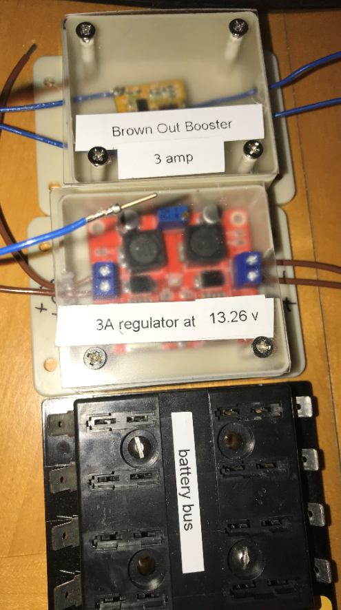

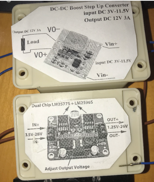

prestonkavanagh
Joined: 27 Nov 2018
Posts: 17
Location: Tarpon Springs
PostPosted: Fri Jan 29, 2021 2:19 pm    Post subject: Re: Some Thoughts on Z101 Reply with quote
This has turned into a thread on alternative ways of providing a brownout bus. As discussed in the past, we don't necessarily need one. Accepting that my Garmin GPS-Comm might cutout on startup, and that there are situations where this would be inconvenient, in my Z101 design I'm including a booster (see attached photos). I built two small boxes and both work. Now I pick one and decide whether to brown-out protect a circuit or add a small brownout bus. Yes, I should add a diode. Other comments? Skip this complication entirely?

PostPosted: Fri Jan 29, 2021 3:05 pm    Post subject: Some Thoughts on Z101 Reply with quote
On Fri, Jan 29, 2021 at 4:25 PM prestonkavanagh <preston.kavanagh(at)gmail.com (preston.kavanagh(at)gmail.com)> wrote:
--> AeroElectric-List message posted by: "prestonkavanagh" <preston.kavanagh(at)gmail.com (preston.kavanagh(at)gmail.com)>
PBK3
PA-12, BD-4, RV6a, gliders
Have you tested the 'dual' version for proper boost operation? The data sheet hints that it is a buck converter; not boost.
As to whether to include brownout: If there's no delay, or the delay in bootup of your installed devices isn't inconvenient, then don't install one. I had hoped that a new battery would solve my issue, but it didn't. I installed one because my older EFIS equipment requires several minutes to fully boot, and often will 'lock up' during cranking, requiring me to shut off the entire airframe to enable a re-start of the EFIS equipment. Livable in winter, but in summer, it just wastes fuel to sit idling so long. (Almost all my flying is from uncontrolled fields, so clearance delivery isn't a factor for me.)
Charlie
It's buck-boost; note the two inductors. The LM2577 does boost and the LM2596 does buck.
