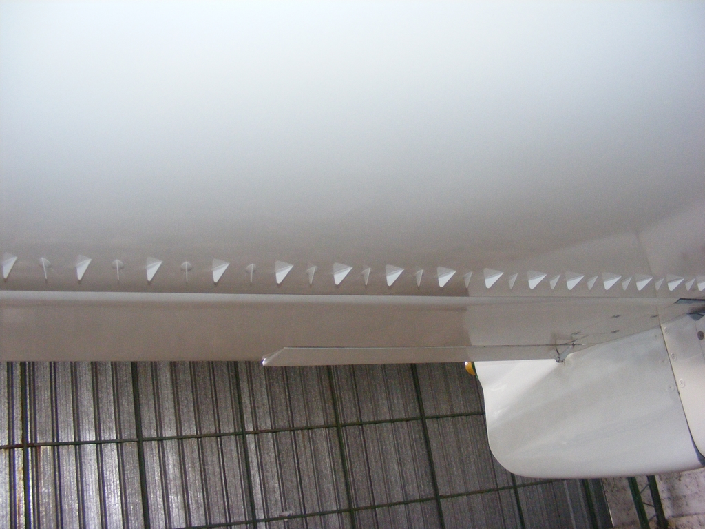

Hi Jeff,
The two I owned were pretty benign. I however placed vortex generators under the surface of the horizontal elevator. They helped a lot and on landing as well.
To our success, Stephen McIntosh

Thanks Stephen, I have a friend that is having success, in his TR-1, with VG's on the wings, I hadn't heard of anyone adding them to the elevator. Was you motivation to improve elevator authority in order to better control nose wheel touchdown or were you motivated by some other characteristic?

Hi Jeff,
Yes, better elevator authority! It made a huge difference!! I placed them underneath the elevator.

FWIW I placed VG's under the elevator and they made a nice difference.

Er .. Is that VG's .. under the 'Elevator' or 'Horizontal Stabilizer '

Yea, that's what I meant.

PostPosted: Mon Mar 22, 2021 6:08 am    Post subject: Stalling the TR-1 Reply with quote
Galin,
I really appreciate all you do for this group and all the advice you give us. On the VG’s, though, I need to respectfully disagree.
The purpose of vortex generators (VG’s) is to generate vortexes to “energize” the air and trip laminar flow air into turbulent flow. This allows the air to take a larger pressure differential before it separates (it can make a bigger, tighter bends before it separates and stalls). This is similar to the purpose of dimples on a golf ball.
In order to be effective in tripping laminar flow to turbulent flow the VGs must be 1) in laminar flow air and 2) be large enough to be out of the boundary layer. (The boundary layer is the area of the flow right next to the skin when the airflow is slowed down due to friction with the skin. It grows in thickness the further from the leading edges of the nose and wings.)
The horizontal stabs on the KR-1 and KR-4 are, like most single engine airplanes, in the propeller slip stream and at the back of the aircraft where the airflow is very turbulent. That means that VGs, especially the little ones (1” or so) are completely ineffective. Kent Pyle, whom I bought my TR-4 from and the world’s worst airplane builder (4.5 years to rebuild and redo everything he did due to unsafe building materials and techniques), had them on the airplane and I removed them.  Good news – Because the flow is so turbulent, the VGs probably don’t add any significant drag, so they really aren’t hurting anything except making it hard to clean the underside of the horizontal stab.
When I bought I flew my flying deathtrap 😊 (before realizing the need to rebuilt it), I simply could not hold the nose wheel off the ground, no matter how gently I touched the mains, and the nose would slam down. Following the advice of some TR-1 builders, I added 3” to the chord of the elevator to give me both more elevator and elevator trim authority (I couldn’t trim the airplane slower than about 90-knots). Three years later, while doing taxi testing, I discovered that the real reason the nose would slam down on landing was not because of a lack of elevator authority, but because the main gear were loose. (Kent used bolts that were too long and he shanked them out, so the main gear where just hanging loose from the airplane in flight and would “click” forward when landing!)  Point is – If you don’t have enough elevator authority, more elevator area is the cure, not VGs. (Note - I have not flown the “new” airplane yet, so I’m not sure what the impact of the additional elevator area is yet on a TR-4.)

Thank you all for your responses. It's time for me to test the waters,
find some altitude and slowly work my way into a stall. Your feedback is
encouraging and much appreciated. I'm definitely considering VG's under
the elevator.
Jeff
KIS TR-1 #099

PostPosted: Mon Mar 22, 2021 6:32 am    Post subject: Stalling the TR-1 Reply with quote
Jeff,
Galin's advice is perfect on learning the stall characteristics of your airplane. As you do it, you'll learn to listen as your airplane "talks to you", and get the feeling and sounds as you approach a stall.
Another point - Stalls, in themselves, are not dangerous, especially in straight, "Hershey Bar" wings like we have. (Swept wings and abnormal, high performance wing shapes can be different.) The wings are designed to stall at the root (near the fuselage) before the tips, so the ailerons, being near the tips, are still effective, even when most of the wing is in stall. Also (and I'm not sure about the TR-1s, but on mine) the ailerons deflect upward much more than downward. This also helps reduce the possibility of a roll input causing the upward-going wing to stall and "snap" the airplane over (called a "snap stall").
The key is to have no yaw on the airplane. Keep the ball centered and use very little (or even better, no) ailerons to keep the plane level. All rudder, no stick.
Keep these things in mind, and you can slow fly, slow stall, accelerated stall, deep stall it all day, and you'll be fine. Practice your recovery (think "push, push" on the stick and throttle), and you'll be an ace in your airplane in no time. And, your landings will be terrific because you'll know how to feel the stall without looking at an airspeed during your landing flair and just kiss the mains on the runway. 😊 (BTW, slow flight and stalling is one of the first things I do when flying a new airplane. Really gives you a feel for it.)
-Doug Crane

PostPosted: Mon Mar 22, 2021 5:27 pm    Post subject: Stalling the TR-1 Reply with quote
Doug, All I know is that as I come to land, the nose drop with the VG's is much less than without them. Not completely gone but noticeably less. Maybe because at that point the engine is not generating much thrust so turbulence, as seen at the rear of the airplane is less, so they can make a difference. This is just me speculating on the reason for a noticeable difference in nose drop at touchdown speed.
To expand on this, when I replaced my aluminum Sensenich propeller with a CATTO composite propeller (20lbs less weight on the nose) the entire problem went away. The slight shift in CG made a huge difference. Now I can grease it in on almost every landing, something I couldn't consistently do before. But then, I am just an "average joe" pilot. <HUGE SMILE>

Galin,
(BTW, I’m a retired Navy test pilot and have a couple of degrees in Aero Engineering, specializing in aerodynamics. Just to establish a modicum of respectability with the group. 😊)

FWIW with the VG's I can approach to land at under 80KIAS with still some elevator authority and touchdown at under 65KIAS something I couldn't do before. But the change in propeller made the absolute biggest difference. Smile
