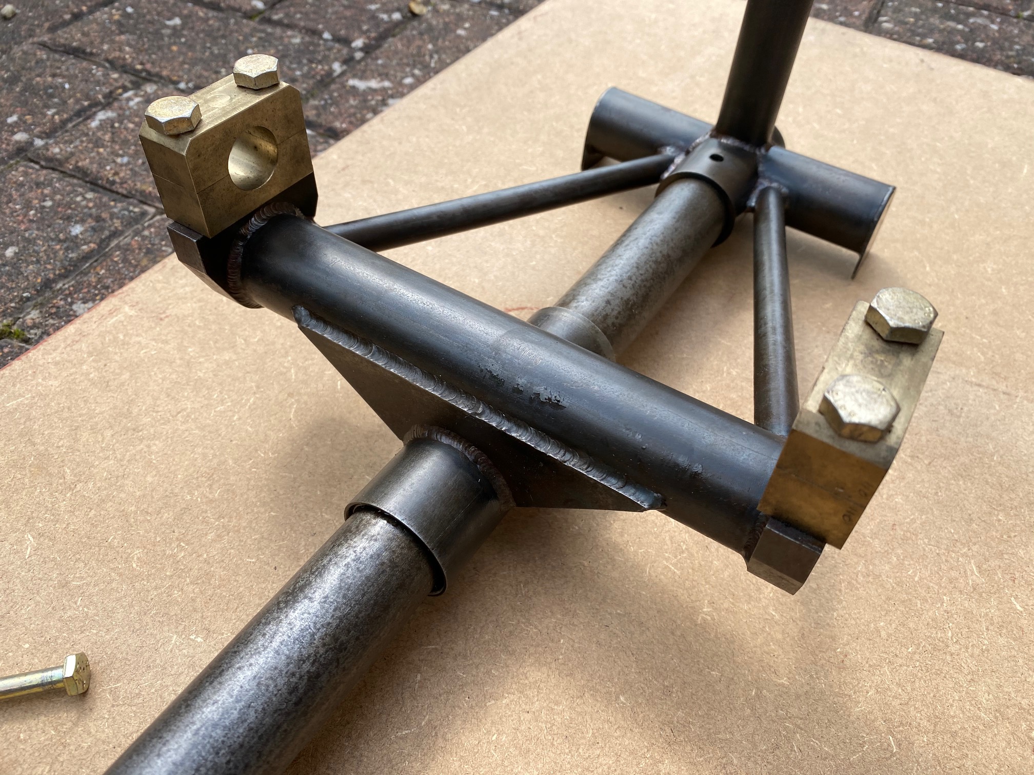

A bit of a random question.
I have a noseleg assembly - NG01 (see the rear part of this in the attached image). Should I be able to disassemble this by sliding the sub assembly off the main tube or is this designed to be a friction fit and unmoveable without great effort?
I'm concerned that there is corrosion between the outer noseleg tube and inner sleeves of the rear sub assembly, which is why I can't separate them to check, but maybe it's not designed to come apart?
Phil

If you’re talking about the leg and the articulating frame, they should be a good fit with loctite to hold them together (from recent experience of replacing both on HI).
