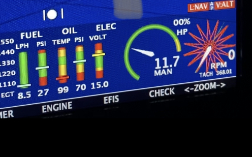

installed my new E-MAG P200-6XL and had to rewire the AFS RPM sensor ( RPM signal wired to the Mag) I also did change the pin from the 5V signal Pin 32 to the 12V signal pin 33. In the software setting the AFS 44500 EM asked for pulses per 2 revolutions, E-MAg says it provides 3 pulses per revolution. I set it therefore to 6.
Problem is now that I get 0 RPM reading and the familiar RPM circle gauge changed in into a red multi-spike star see attached picture. Anyone has an idea what gone wrong?
On the setting page I can see the pule count working.

Problem solved. It looks that the data has not been correctly saved. I changed the max RPM value and saved it. RPM gauge is back like it was before and the reading is correct as well.
Mike
