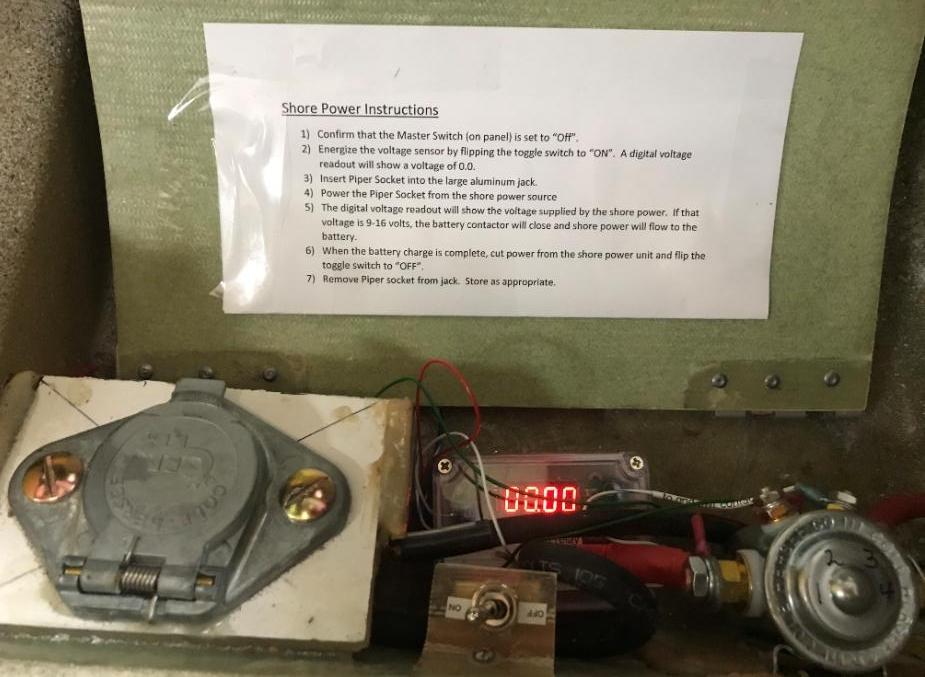

PostPosted: Sat May 29, 2021 8:28 am    Post subject: shore power Reply with quote
Bob's write up made this a fun little project, now easily accessed while hidden away under a rear seat.
 Filesize:  76.86 KB
 Viewed:  3191 Time(s)
PBK3
PA-12, BD-4, RV6a, gliders, Rutan canards
