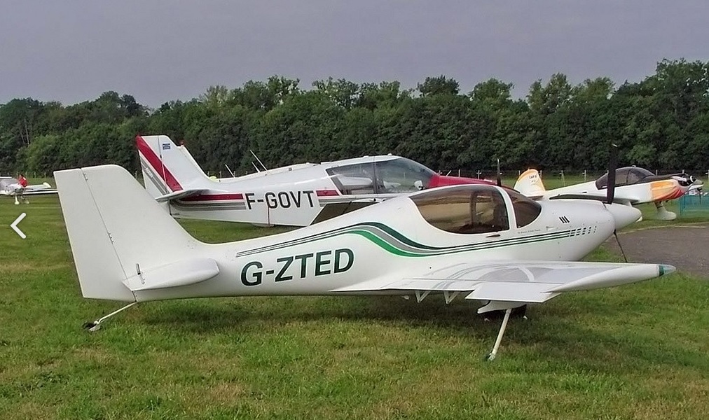

I don't know if it can be easily done after completion (anything can be done with enough money and time!) but Justin Kennedy and Ted Gladstone did it during their build...
Also don't know what is involved, sorry!
