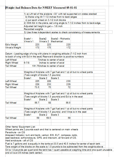

i have access to 3 scales .... does anyone know the weight numbers for the landing gear and tail wheel for the FireStar 2? ................................ 2 broke Tim

Yep. Good luck making sense of it...
