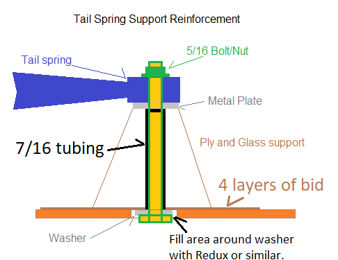

Many years ago I suggested a modification and all mono's that have gone through my shop have been modified. It allows a bit more security of the bolt, prevents bending and crushing of the glass/ply support. The top of the bolt could bend if your metal sleeve is sloppy. So far, my clients have all held up. I'm afraid it has been many months since I've done a tail spring mod. I've attached a drawing that may be some help.
Essentially, I install my spring retaining bolt considerably different. Review Mod 43. My additions are to hollow the skin out and lay reinforcing plys of bid on the belly. I add a 5/16 nominal washer to the recess.
I then cut and fashion a chrome moly tube reaching the length of the bolt from the metal plate down to the washer in the skin. The 7/16 0.065 wall tube I used had to be reamed out for the 5/16 or 0.3125 inch bolt seemed to be firm enough to support full bolt torque but I’m sure that a 0.049 wall is sufficient as the torque on the bolt is about 100-140 inch pounds which is not terribly high.

Ron Peach
Joined: 19 Sep 2020
Posts: 7
PostPosted: Fri Jun 25, 2021 11:05 am    Post subject: Re: Europa Classic Tail Spring Attachment Reply with quote
Duncan, Bud,
Thanks very much for responding. Bud your mod makes sense but at this stage I'm looking for an easier solution. I am currently planning to replace the original steel plate with an exact copy, re-bonding it to the ply/bid platform and putting in a new bolt (I found indications of light corrosion on the bolt at the point that it passed through the steel plate).
In Graham Singletons mod (PFA 10371) he mentions using 1/8th sheet bent to form a 1/2" by 1" angle to 'reduce the tendency to bend and crush the plywood/bid reinforcement'. With no other detail, I presume that this would go on top of the steel plate with the bolt passing through it as well. I can see how this mini girder could help spread the load.
I also read in a report (of a tail wheel failure) that six or seven mono owners had fitted a mod that comprised of two light alloy plates bonded to either side of a block of Paxolin. This was claimed to provided additional lateral support for the bolt. The report stated that this mod was approved by the PFA but I can't find any evidence of that.
Anyone else out there with knowledge?
Ron

Ron,
Bud Yerly
