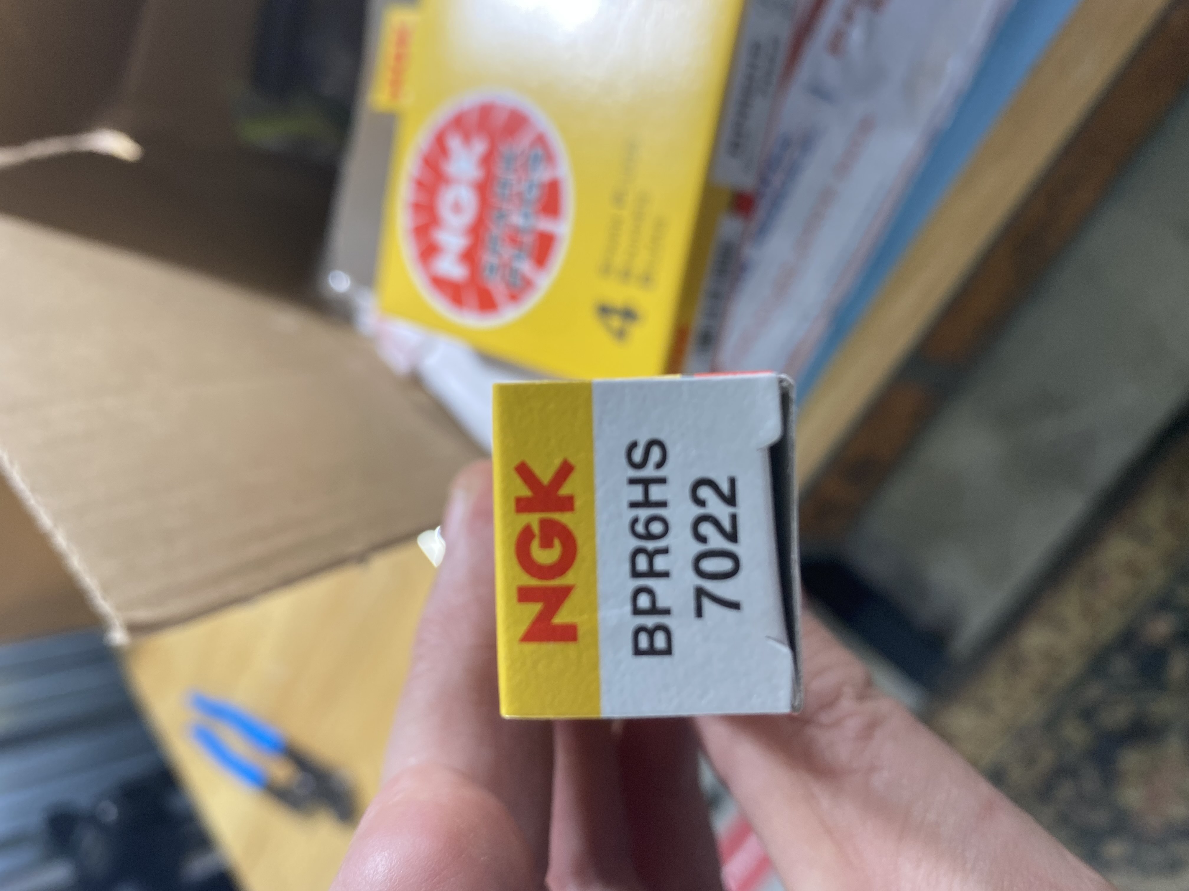

pennington.construction.i Guest
Posted: Fri Oct 08, 2021 7:56 am Post subject: I know this question has been asked,,,,but |
Currently at the hangar. NGK 7022
Mark
N621CJ[img]cid:17c609d802826d54d5a1[/img]
Posted: Fri Oct 08, 2021 8:14 am Post subject: I know this question has been asked,,,,but |
Dennis can chime in here but I thought both engines used the 14mm 7022 plug. I run an M14P using 7022.
Mark
N621CJ

richard.goode(at)russiana Guest
Posted: Fri Oct 08, 2021 8:16 am Post subject: I know this question has been asked,,,,but |
As Mark has written – BPR6HS – of course made by NGK. Excellent plugs with the additional advantage of being long-reach so giving good flame propagation inside the cylinder.

dsavarese0812(at)bellsout Guest
Posted: Fri Oct 08, 2021 8:21 am Post subject: I know this question has been asked,,,,but |
Yes sir. The 7022's are the same plugs that come in my kit. Gap at .020 and don't forget the anti seize compound on the threads. Also, if you have CHT probes on the any spark plug, remove the factory washer before installing with a CHT probe. Torque to 22-23 Ft. Lbs.
