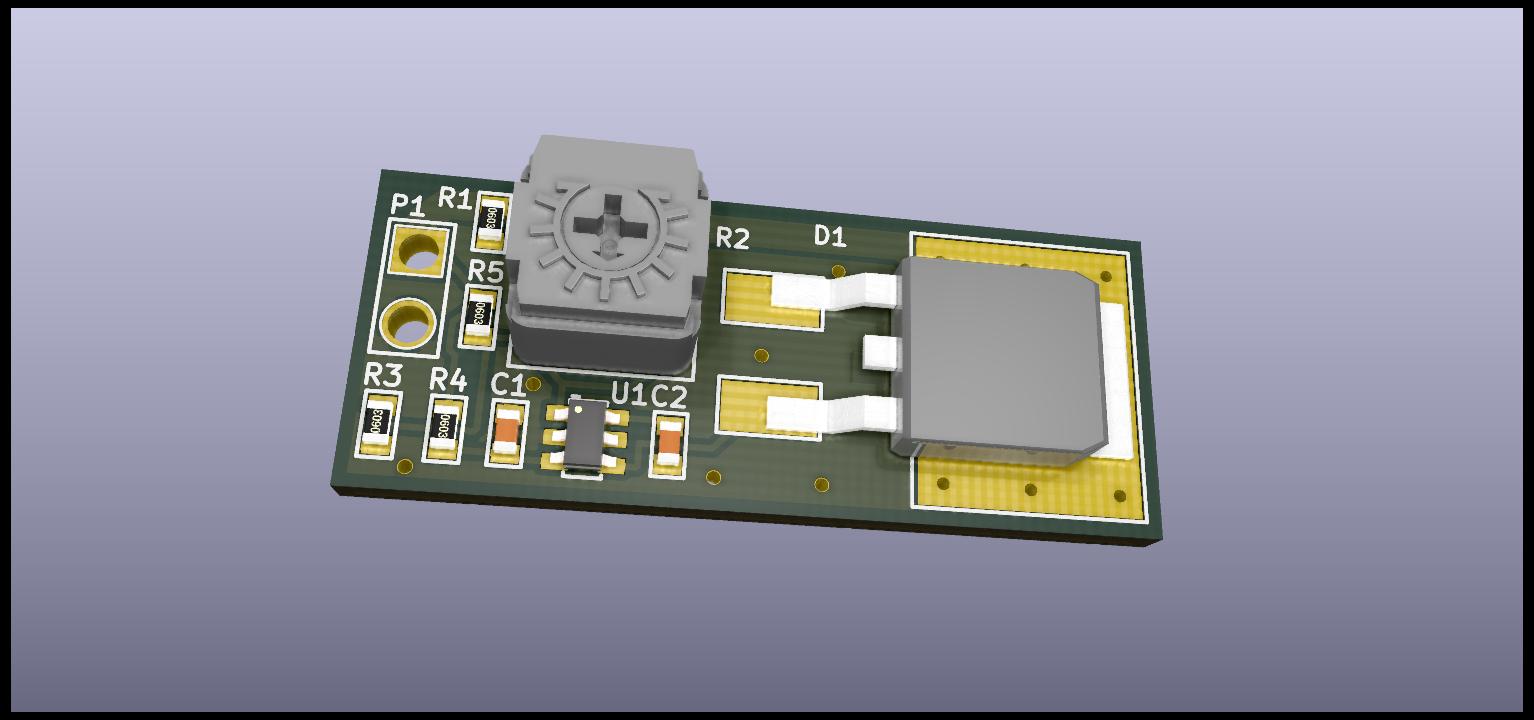

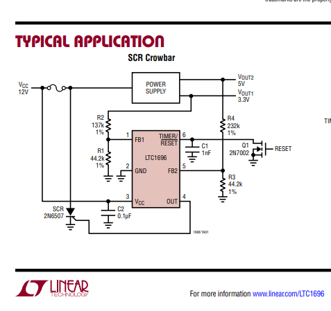

I've noticed the stand alone overvoltage switches are not as readily available and I asked a friend of mine if he would put together a board using an IC provided by Analog Devices.
https://www.analog.com/media/en/technical-documentation/data-sheets/1696fb.pdf
So, my friend completed the design and is sending to me, what he says, are well operating switches. I'll test the switches when they arrive in a few days but I'd like to ask for any feedback on the design. (see attached pdf of the schematic).
He says the device behaves as expected, tripping is adjustable from 15 to 18 volts and running current is less than 5 ma. The R5 is not used and is included only to allow for a fixed trip point (rather than adjustable with the pot).
Thanks in advance for any comments.

Looking at the 3D rendering image that you posted, I would be worried about the board layout. If the trace under the "R2" and "D1" markings is the only copper carrying trip current to the SCR, and if it's as narrow as it appears, then I'm concerned that the trace may burn open before it can blow the fuse. Blowing a typical fuse in a reasonably short time takes significantly more than its rated current.
See the time-vs-current chart in this datasheet, as an example: https://tinyurl.com/29c28u3y+
If your friend also used bottom side copper to carry trip current then it may be fine; I just can't tell from the image you posted since it only shows the top side copper. I would definitely perform a full function test by connecting it to a car battery through a fuse with the same current rating that you intend to use, then wind down the pot until it trips (wear a glove and eye protection; a blown trace can throw molten copper). If the fuse blows with no damage to the board, then you've got a winner.
If not, then a better layout would put the SCR right next to the input wires with large copper pours connecting its anode to the input and its cathode to ground. The controller IC, potentiometer and passives can go at the other end of the board.
Do you happen to know why there are four resistors on the board? Establishing a trip range only requires two resistors and the pot.

If nuisance tripping occurs, a capacitor (s) connected between U1 Pin 1 (FB1) and ground might help.
Eric, post 1 explains that R5 is optional to eliminate the pot.
Thanks for the observation Eric. A good question and I'll ask about it.
Yes, I had planned to test the board extensively (with a battery driven circuit) when they arrive.
With regard to the resistors, no doubt that addiing the components seems rather arbitrary to me as well, particularly R5. The pot + R1 was a convienience related to resistor sizing and availablility.
Dan Theis
Thanks Joe,
I meant to include the data sheet for U1 in my original post and on page 10 (I believe) they define modifying C1 to achieve a debounce desired.
I think the existing selection provides a time delay of 10 to 11 usec, depending on the voltage sensed. Yes, I think you are correct that this might be a bit too "twitchy." Using the added cap as you suggest is certainly an easy way to modify the behavior without component replacement. Something that might be necessary for any specific aplication.
