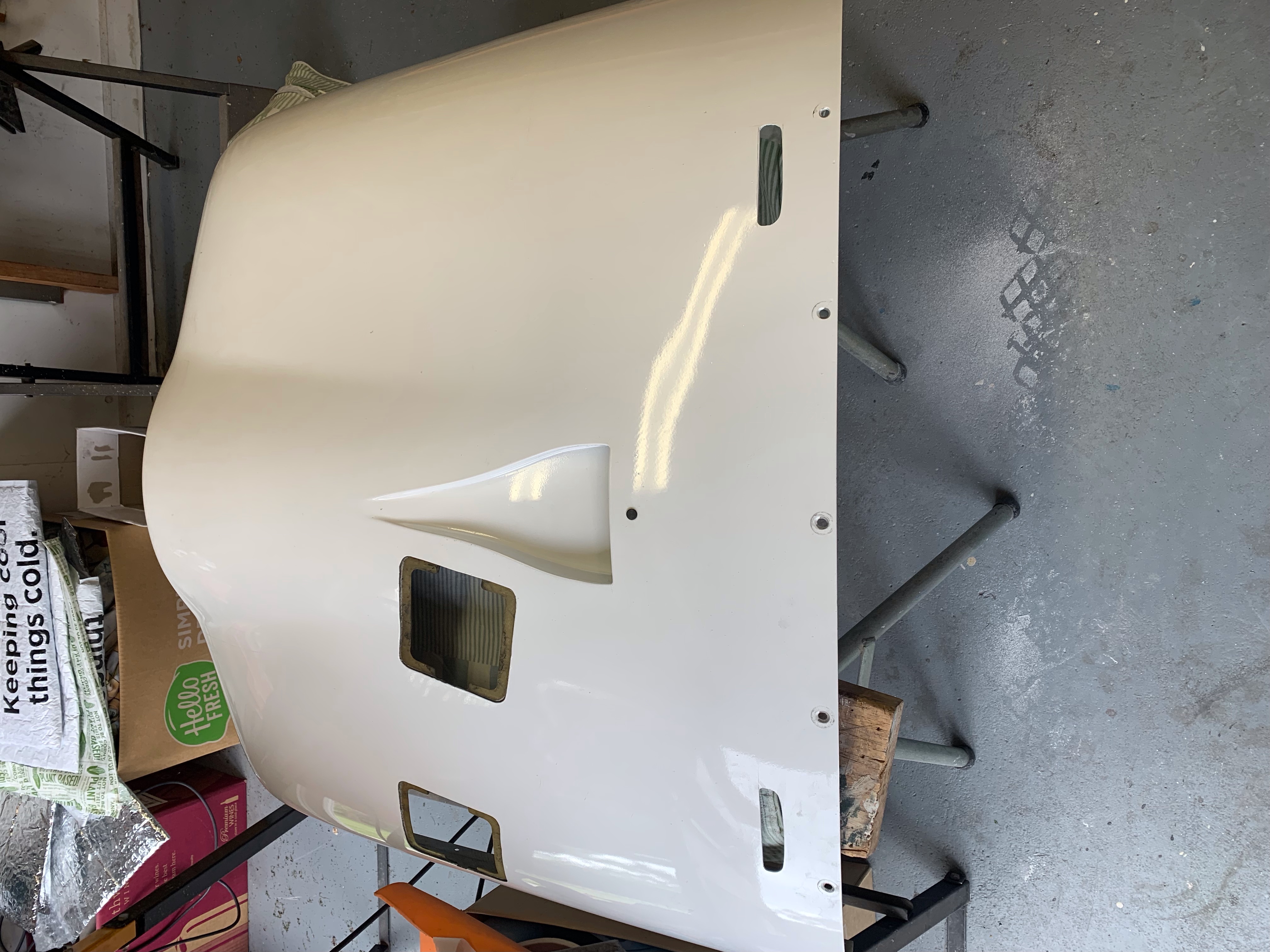

Hi Darren,Measurements not given in the Mod 43 so I made my Naca Duct dimensions approximately 100mm x 25mm. I also centred it on the top cowl, looks better and not in the way of the coolant cap. See photo.

Darren,That is the opening into the plenum chamber approximately. If you are not in a hurry I can measure it exactly next time at the hanger. The length is really up to you, however a gentle entrance to direct the airflow would be better. Not too much pressure build up. See photo.

Hi Darren,Have visited the hangar to take some measurements of the Naca Duct.
The opening is 120mm x 34mm.
The length of the duct is 230mm.
Duct width starts at 20mm to 120mm.
Centred from the Spinner.
Hope that helps, good luck.
