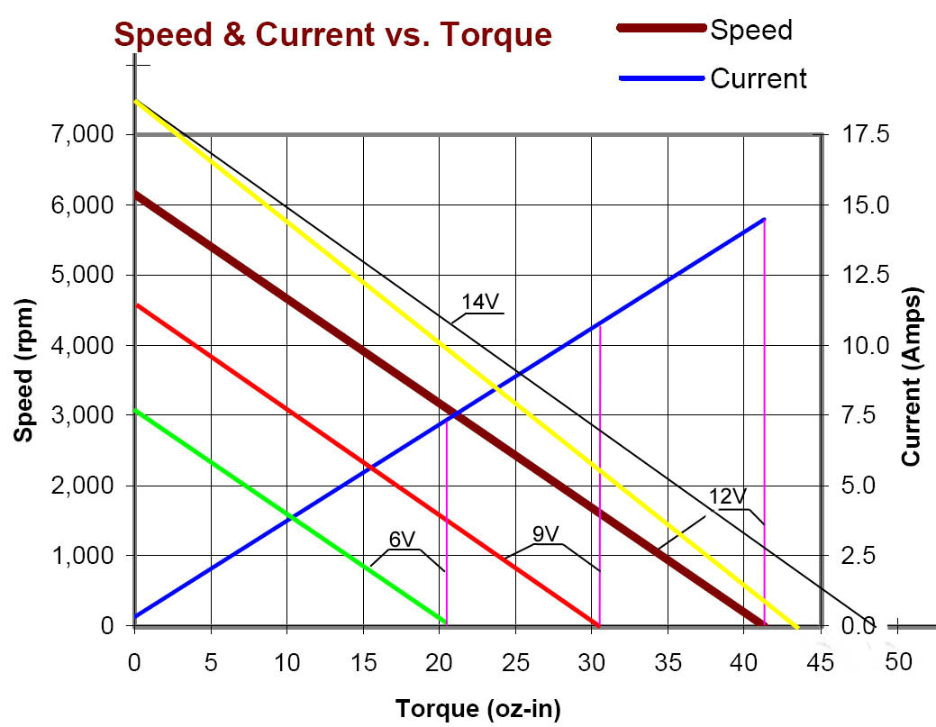

There's a hangar full of bad science out
there about motor performance but here's a
place to start:
The attached curve is an EXEMPLAR performance
plot for a PM motor. Note that TORQUE is
directly proportional to CURRENT. RPM is
proportional to VOLTAGE. Hence, assuming that
the motor is operating within design limits,
a slowing motor is starved for VOLTAGE. In
the case of a trim system, torque loads are
not a function of trim speed . . . so if
speed regulation is poor, it's a prime notice
that VOLTAGE regulation is poor . . .series
resistors turn a constant voltage source
into a wet noodle.
Note that there is ONE plot for torque vs.
current that's true for ALL voltages. No
load RPM and STALL current are proportional
to voltage (note 6v stall is 1/2 that of
12v stall).
ACTIVE voltage regulators incorporated as
suggested in the drawing are CONSTANT
VOLTAGE sources irrespective of load.
Motors do not automatically 'draw more
current' as their driving voltage is reduced.
Using a series resistor to control speed
makes speed regulation so poor that it SEEMS
as if motor current is being modulated with
speed . . . not so.
out of that stuff?"

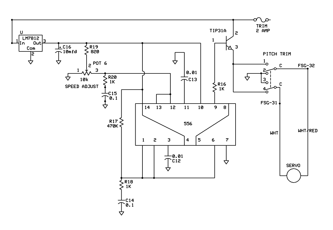

Bob, thanks for the information. If I ever redesign my trim circuit, it will contain a LM317.
You asked about the RV-12 trim circuit. Attached is a schematic of the original trim circuit.
Van's has completely changed it in later models. But they still use PWM.
 Filesize:  18.23 KB
 Viewed:  3578 Time(s)
