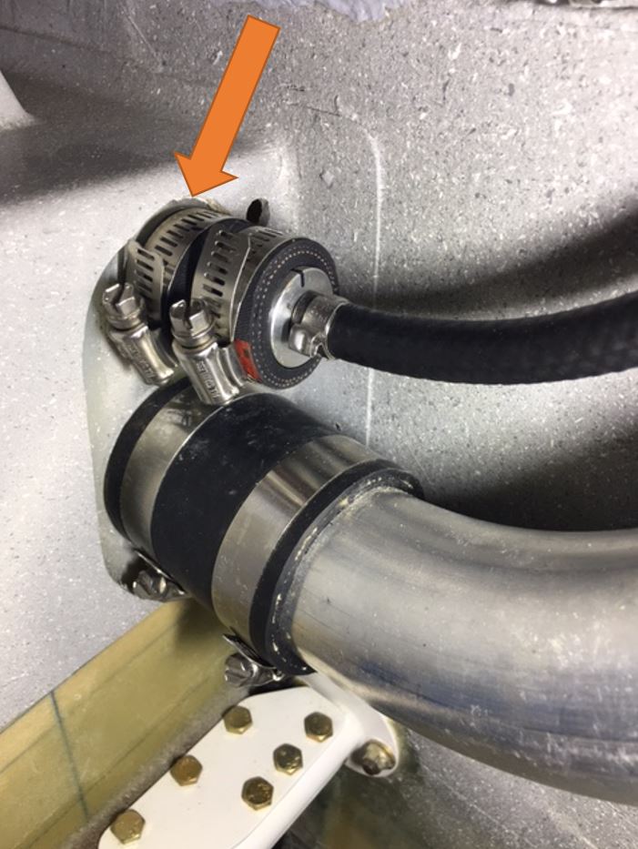

Thanks to all this feedback I think that my initial selection of hose was appropriate. The swelling I am referring to is at the line between the plastic boss and the aluminum fitting. The fitting is properly in the boss. Why did it happen who knows. I will try to make a picture of it.
Will, not sure about your question but here is a picture of the newly installed vent. As you can see, the CM fiberglass goes around the boss. It used to be a little tighter and the coupling hose would butt against it preventing from being inserted further in. I ground off some of the glass to increase the clearance which you can see the picture shows the hose further into the boss almost to the tank.
I think I will be fine. Will keep an eye on these components and if I have issues again will find some other brand of hose.

PostPosted: Fri Apr 01, 2022 9:05 am    Post subject: Fuel coupling hoses at bottom of fuel tank Reply with quote
Chris,
The hose over the fuel tank boss (which is about 1.125 inches) and the fuel fitting requires a hose that will stretch. I thought perhaps you saw the stretched hose and figured it swelled from your original post.
The tank vent and filler area have been issues for those who fail to pay attention. I've had to put aluminum tube in the 2 inch fuel inlet from the fuel filler because guys cranked the clamp so hard they crushed the fuel filler boss. The vent and filler area of the module is normally cut conservatively without thought to fitting on the hoses. The fiberglass has to be relieved to clear for the hose and clamps. I have a drawing on this attached

PostPosted: Sat Apr 02, 2022 3:56 am    Post subject: Re: Fuel coupling hoses at bottom of fuel tank Reply with quote
Thanks Bud,
The hose I am using stretches around the boss, with a little effort, but no problem.
The idea of using an aluminum sleeve inside the boss is very good. At this point I don't see any crushing of the bosses so for now will just keep an eye on things and will carry on.
