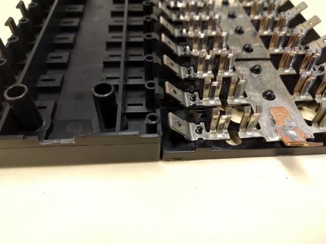

PostPosted: Sun May 08, 2022 3:29 am    Post subject: Re: Too many Circuit breakers.... Reply with quote
Charlie, Maybe my Busman fuse block was defective or maybe I am too much of a perfectionist. But the fuses did not require much force to pull out. The spring contacts only gripped the fuse at one location. I made my own fuse block using contacts similar to spade connectors which grip the fuse on two edges. See Mouser part number 534-3522. I have to use a tool to pull a fuse out.

PostPosted: Sun May 08, 2022 5:04 am    Post subject: Too many Circuit breakers.... Reply with quote
On Sun, May 8, 2022 at 7:42 AM user9253 <fransew(at)gmail.com (fransew(at)gmail.com)> wrote:
--> AeroElectric-List message posted by: "user9253" <fransew(at)gmail.com (fransew(at)gmail.com)>
Joe Gores
This is what the Bussmann looks like inside. (I 'modded' one to have two buses in one block.)
