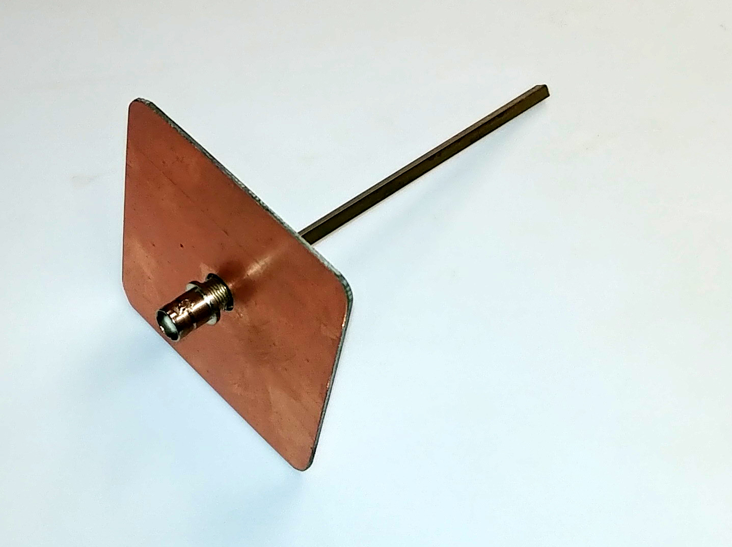

PostPosted: Mon Jun 06, 2022 4:58 am    Post subject: Re: simple antenna for 704 mHz Reply with quote
Rumen, did you resolve your antenna issue? If not, I may have a potential solution. I've got a 'thru the roof' antenna I built for a local EMS member that's too long (465 Mhz) that can be cut down to accommodate your target frequency. It was originally intended to poke thru a metal roof via 5/8" hole and bond to the inside surface for weather sealing. It would also work nicely thru a side wall of the building.
It's only a 4" 'spike' protruding off the surface . . . unobtrusive. Easily removed and patched in future.
I can dig it out and trim to your requirements.
