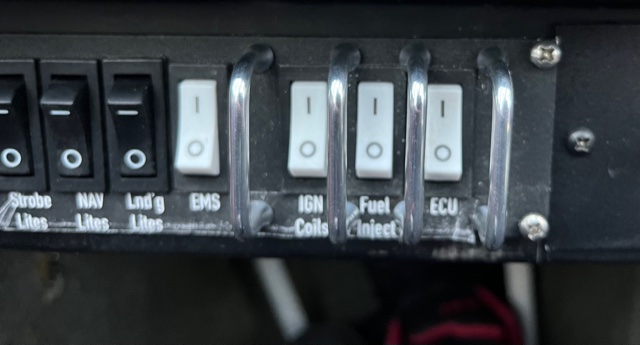

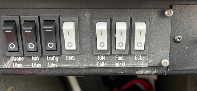

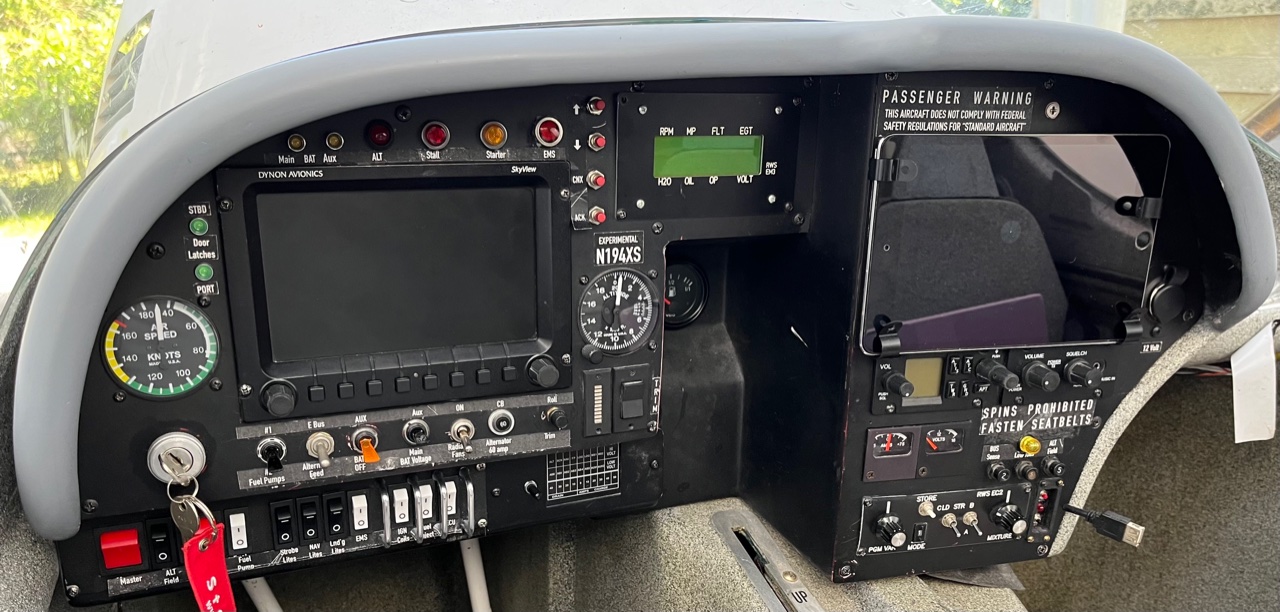

...could have saved many $ of repairs, etc. etc., and so forth….
On Jun 2, 2022, at 1:25 AM, davidjoyce(at)doctors.org.uk (davidjoyce(at)doctors.org.uk) wrote:
Fred, I am sure you won’t need telling but it is worth emphasising that any safety critical switch ought to be positioned or surrounded by some sort of guard so that it cannot be inadvertently switched off in flight.
David…per your advice, I have added switch guards for the 3 engine/flight-critical rocker switches which, in my panel layout, are susceptible to inadvertent opening or closing…thanks, Fred
