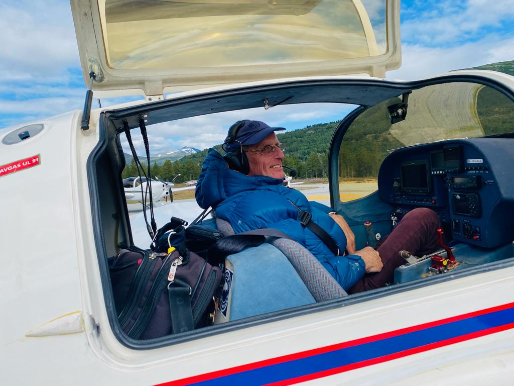

PostPosted: Wed Mar 01, 2023 1:33 am    Post subject: Beringer wheel Reply with quote
Here is how my centrally mounted brake lever looks. There is a park brake button just out of view on pax side of installation. Ergonomic inasmuch as very close to throttle. Installation fairly complicated but well within abilities of anyone who has built his plane. I am not an instructor but have found myself flying from R hand seat on a number of occasions over the years and as we all get older and probably do more buddy flying it is comforting for either pilot to have ability to land the plane. David Joyce
