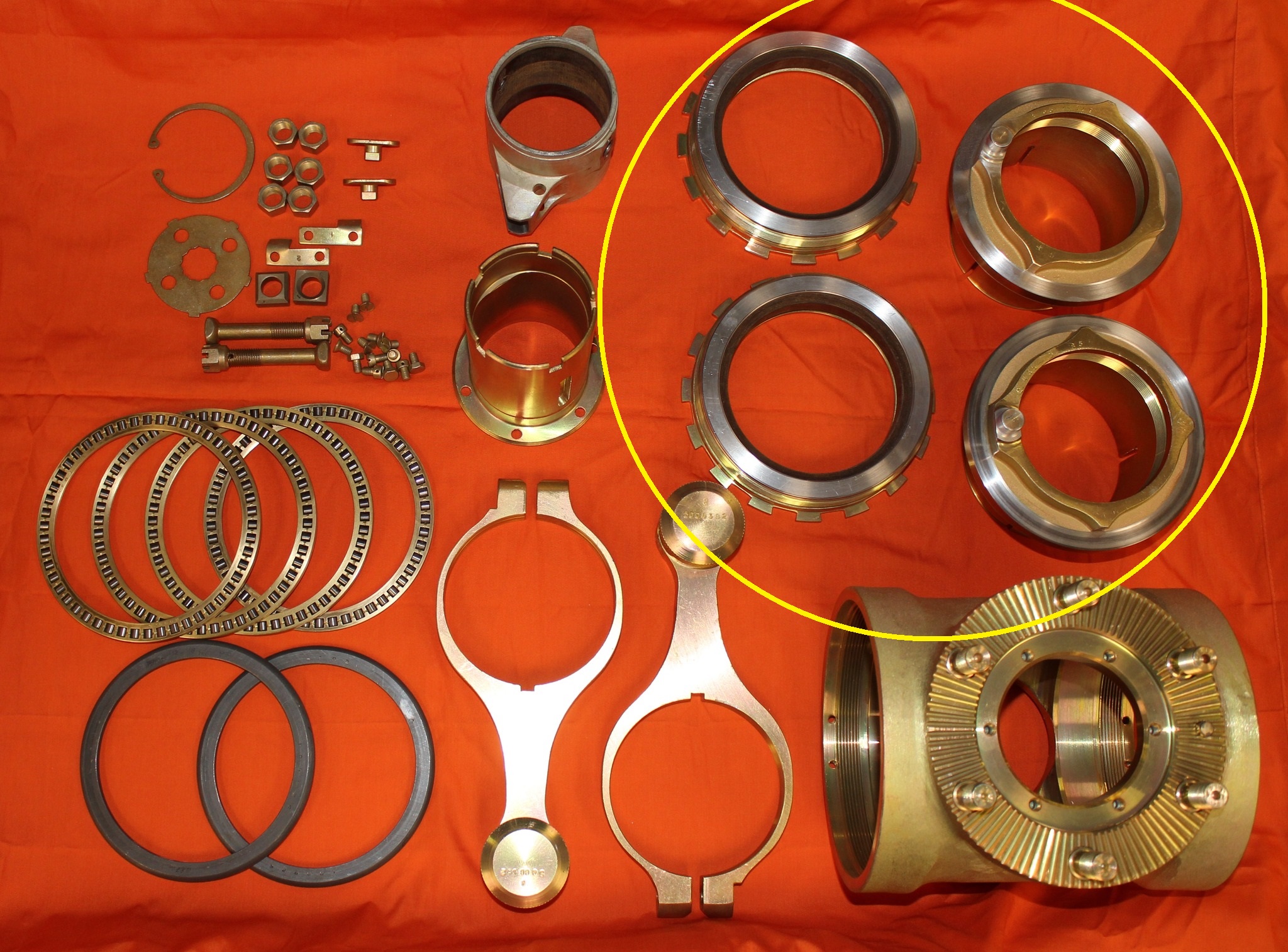

I am still looking blades for my 375 hp Huosai engine and I did not find an answer about an hybrid Huosai /Nanchang hub with yak 52 blades.
I know that for testing, aerometal / Richard Goode use a PZL wilga hub with std wooden blades (Aerometal told me that this combo can handle a lot of power) so my idea is to keep my hub but with yak 52 blades (oem, whirlwind, or any other).
Do you know if the Yak 52 blades nut can be used in the Nanchang hub?

Sorry Richard, my message was not to talk about the hub you are using but to know if the blades of a Yak 52 hub or any other M14 hub could be adapted on a Nanchang hub.
As Marcell from Aerometal had told me that he used a hub from a PZL Wilga, I wondered if we could mount the bolt / bearing from a hub of Yak 52 on the hub of Nanchang and therefore use blades from Yak 52 or others like Whirlwind.
