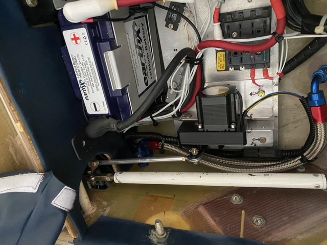

What size DYNON roll servo have any of you used for the KIS4 and where did you mount it?

I used the smallest of the three available after determining that the movement was more than adequate. I installed it on a mount under the pilot seat on ground plate I had originally sized for the mount. The difference between your setup though is that you have the dual stick vs my single center stick.

So you used the SV-32 servo with the standard output arm?

I used the SV32 but ordered the longer arms, cut and tapped to length needed after mounting servo.

Did you have to cut much?

Which time? My first attempt had everything interfering with something or so it seemed. Had to reposition the servo closer to the connection on the center stick but that required a move of a couple of inches. Ended up cutting off about an inch or so if I remember correctly.
What was supposed to be a couple hour job turned into a multiple day job. Especially so for the rudder servo which I mounted under the center console between the front and back seat. I won't tell you how many expletives I uttered during all of that, would need a computer to calculate.
Anyway, everything is finally in place and proceeded to fight with the Dynon System to get it to recognize the servos. Haven't had the chance to fly it yet.
Bob
