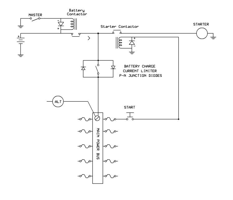

user9253
Joined: 28 Mar 2008
Posts: 1978
Location: Riley TWP Michigan
PostPosted: Sat Jul 08, 2023 2:07 pm    Post subject: Re: Excessive Amperage Reply with quote
Attached is a picture of a circuit which will limit the battery charging current.
It might be desired to limit the charging current to a lithium battery that is
too small to accept the full alternator output. Or it might be desired to limit
the charging current to avoid overheating the alternator. Choose diodes that
will drop about a volt and that can carry the expected current. Since the
charging voltage is one volt less, the charging current will also be less.
The bypass switch can be closed to charge the battery at full Voltage.
An on-delay relay could be used instead of the switch to reduce pilot workload.
 Filesize:  33.57 KB

PostPosted: Sat Jul 15, 2023 11:14 am    Post subject: Excessive Amperage Reply with quote
Get BlueMail for Android
On Jul 8, 2023, at 6:44 PM, skywagon185guy <skywagon185(at)gmail.com (skywagon185(at)gmail.com)> wrote:
Paul,Check out the various YouTube videos that deal with RV travel with the solar market.
Many have converted to lithium batteries for their solar storage and great power capacity.
They have the same problem, namely stock alternators burning up trying to supply max amperage at idle speeds.
Resulting in too little air cooling.
Companies like Victron, Renegy, etc., etc., make "Charge controllers" to safeguard the alternators from overheating.
On Fri, Jul 7, 2023 at 2:49 PM Paul Eckenroth <N509RV(at)eckenroth.com (N509RV(at)eckenroth.com)>
wrote:
DavidYou refer to gizmos made to take control of the charge rate such that it stays under the alternators design limits. Can you be more specific as to what these gizmos are. I have been looking for something like this to try and keep the stator in my Revmaster engine from burning up again. I believe that controlling the output is the key.
Paul
On Sun, Jul 2, 2023 at 2:19 PM skywagon185guy <skywagon185(at)gmail.com (skywagon185(at)gmail.com)> wrote:
Battery....Lithium
Joe makes a very good point about the potential of Lithium base batteries to potentially cause charging problems.
The other side of this combo is that when a "normal" alternator is running at idle speeds the Lithium is able to handle receiving a very heavy current charge rate such that the alternator could easily overheat and burn some internal part due to lack of cooling for such a heavy current draw. There are gizmos made to take control of the charge rate such that it stays under the alternators design limits.
The marine and RV folks use these controllers to safeguard their expensive stuff.
David
On Sun, Jul 2, 2023 at 6:02 AM user9253 <fransew(at)gmail.com (fransew(at)gmail.com)> wrote:
--> AeroElectric-List message posted by: "user9253" <fransew(at)gmail.com (fransew(at)gmail.com)>
Below is from https://earthxbatteries.com/faqs/
I just installed my EarthX battery in my aircraft and started the engine and my charging amps was really high, is this normal?
Yes, this is normal. A lithium battery can and will accept a much higher charging current than an equal size lead acid battery.
If your battery is not fully charged, your alternator can potentially output a current equal to
or slightly above the alternator’s rating for a few minutes to top the battery off.
You must use a lithium battery that is designed to handle the current from the alternator
or you can damage the battery, cause premature failure or possible even cell rupture.

I presume we're talking about a lithium battery.
There have been suggestions for limiting recharge
current with connection of two diodes back-to-back
in series with the battery.
This is NOT a current limiting technique. It
serves only to insert a VOLTAGE DROP in the
battery connection of approximately 0.8 volts.
One can achieve the same result by adjusting
the regulator set point down by the same
amount of voltage (see below). The notion that adding
diodes is an appropriate prophylactic against
alternator damage is in error.

PostPosted: Wed Jul 26, 2023 6:00 pm    Post subject: Diode Limits Charging Current Reply with quote
Bob, read this https://earthxbatteries.com/dual-bus-lithium-battery-design/
by EarthX. A diode does indeed limit lithium battery charge current. Quote from EarthX:
"When a diode is used to connect the main bus to the essential bus, a .5V drop
across the diode lowers the charge voltage, thus limiting the charge current."
I was just offering a way to lower the charging current to solve the OP's perceived problem.
Of course it seems that the consensus is that there is no problem.

The article suggests that dropping the charge
potential to the standby battery by ~0.6V would
prevent this deleterious inrush. The lithium
battery's ability to draw such currents is
based in part on its internal resistance. Hmmmm . . .
if 0.6 volt reduction is a 'magic' endeavor
what would happen if we put some small resistance
in series with the battery . . . say something
on the order of 50 milliohms.
Okay, try to stuff 30A thru 50 milliohms would
get you a drop of 30 x 0.05 = 1.5 volts!
That suggests any potential for 30A inrush just
evaporated.
Now, after the battery approaches full charge and
recharge load drops to say less than 1A, then
the drop becomes 0.05 volts . . . okay, no big
deal. Even with our resistor in place, the battery
WILL become full charged.
What would one expect for a voltage drop
in an 'emergency' situation? 6AH battery . . .
endurance load of what? 4A? That would give
you approximately 90 minutes endurance when
the battery is new . . . 70 minutes at end of
life. Okay 4A draw through 0.05 ohms is 0.2
volts . . . again, no device wanting power
from that battery would care.
Where does one get a 0.05 ohm power resistor?
How about 5 feet of 20AWG wire at 0.010 Ohms per
foot? It's certainly 'beefy' enough to carry
expected normal loads with negligible effect
on system performance while ADDING series
resistance to the battery thus corralling it's
willing to self destruct when charged from a
'stiff' source.
