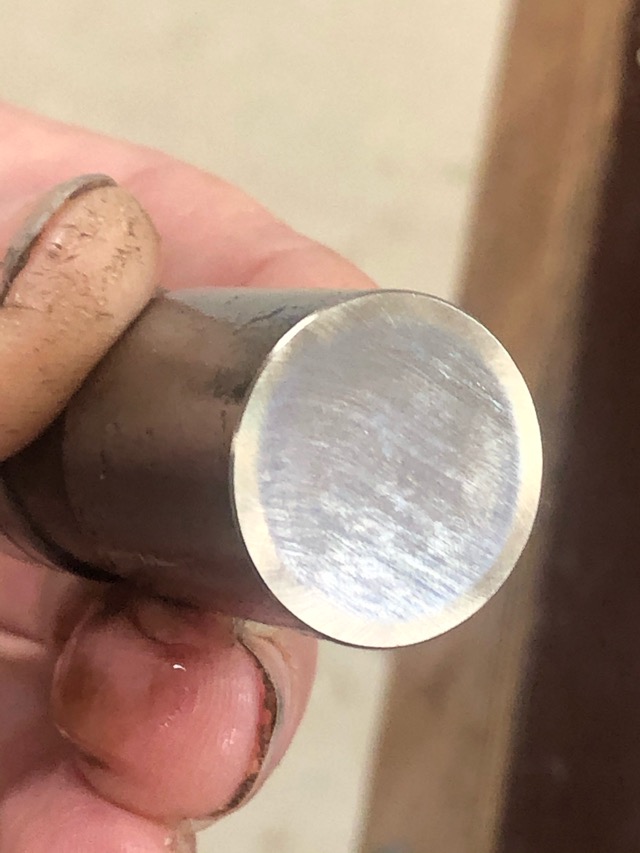

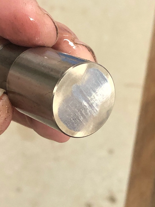

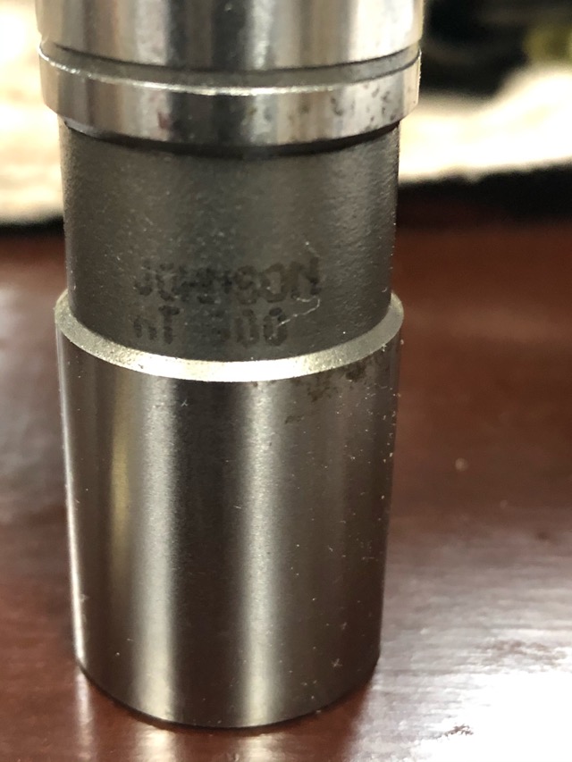

• I am tearing down a 1999 914 with 105hrs TSN. It has Johnson HT-900 (Ford 351 Windsor) lifters fitted. 50% of the lifters are presenting signs of early failure at the lobe contact face. There is no EDM oiler port on these units. Were Johnson lifters ever fitted as OE components on the 9 series engines?

A good lifter, rotating in service

Starting to fail after just 100hrs due to not rotating in service.

Johnson HT-900, Ford 351 Windsor

At first my initial thoughts were leaning toward operator error of insufficient engine warm up prior to T/O where the lifter to crankcase expansion lag was causing the lifter to not rotate; which was somewhat correct and not correct.

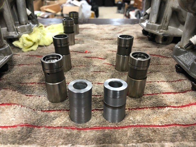

Some gauges were turned up on the Czech Hobbymat lathe. One gauge was made oversize to determine unserviceable bore sizing of ^0.0015". The other gauge was matched to the 914's unused portion of the bore. It was a good exercise with the added benefit of learning how to perform 0.0005" precision passes.
In the end the gauge revealed that the engine left the factory with 0.00015" operating clearance. This alone would prevent the lifter spinning in the bore as required. Introducing lifter to crankcase expansion lag would reduce this clearance further again. There is minor scuffing on the bore indicating metal to metal contact binding. So far information filtering in has this situation presenting in 1999 and prior manufactured engines.

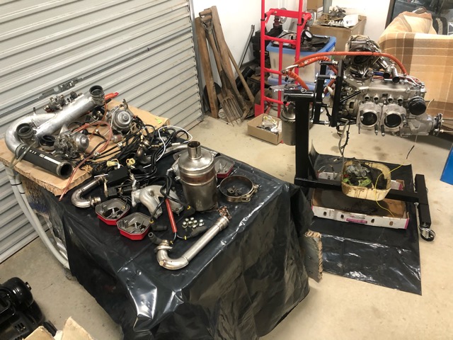

Mostly torn apart for inspection

Very interesting, Ford lifters. I would be a little surprised if those were put there by Rotax in Austria! I will ask someone with Rotax experience and get back here. I know old american V8's mostly.
The Rotax service manual's & parts catalogue show very conventional lifters without those Ford part numbers, actually when I looked that Johnson HT-900 I get a aftermarket part. Made in USA , they claim to be best in the world.
