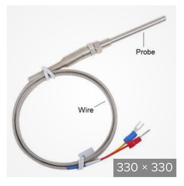

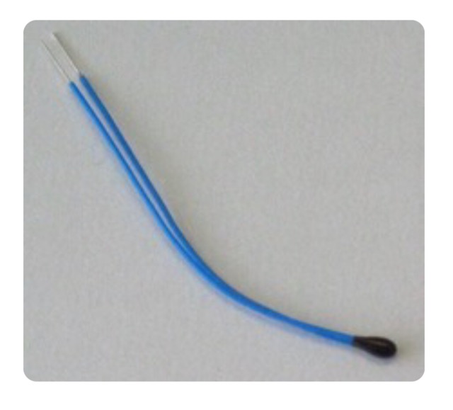

It's better than nothing and may be a little inaccurate due to factors such as external ambient air flow within the engine area passing over the compressor pipe itself; so the reading may be under actuals.
The best sensor is one that is immersed within the compressor free stream. A 'K' thermistor would suffice (which will be what you have attached already). Thermocouples are more accurate and more expensive and are used on Rotax.
The 914 HMM provides thermocouple sensor impedance reference graph for the plenum temperature sensor; you could possibly splice into this circuit for a piggyback reading, and you would need to ensure there is no risk of damaging the TCU by doing so. A comparable screw in thermocouple sensor itself costs about $8-$25 on ebay.
Thermocouple

Thermistor
