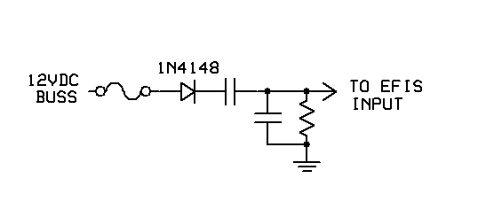

PostPosted: Tue Oct 10, 2023 11:04 am    Post subject: Re: 3-phase current monitor Reply with quote
Alternator problems such as loosing one phase or a diode failure result in a
higher AC component of the DC output. Based on that, perhaps something
like the circuit below connected to an EFIS input will warn if the AC
component is higher than a normal setpoint. If the signal is too weak, it
could be amplified. Is this idea feasible?
