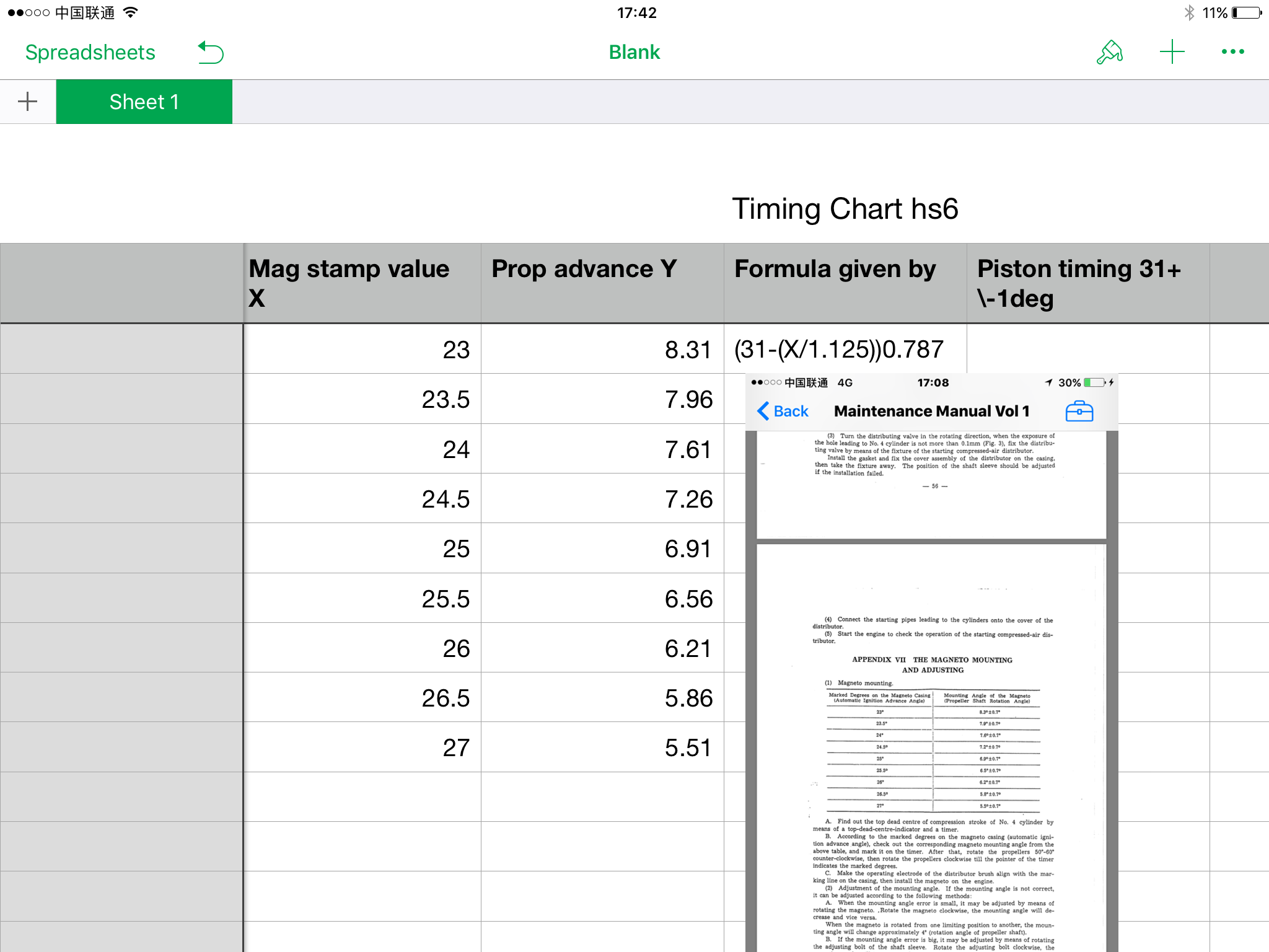

PostPosted: Tue Jul 04, 2017 1:48 am    Post subject: Re: Mag timing HS6A is the book wrong? Reply with quote
I think my esteemed colleague woodja has come up with the answer:
advance on magneto is calculated as the angle the advance moves on the device itself ,
nothing to do with piston , prop or anything ...thus ,
I read the magneto is geared at 1.125 internally. This from Tech specs ...
So 27 degrees of magneto advance only equals 27/1.125 , or 24 degrees of piston advance .
24 degrees from 31 +|-1 degree (from tech specs ..)
is the TDC degrees piston firing point ,
equals 7.0 degrees of piston advance required ,
which , multiplied by .787 equals
5.5 degrees of prop advance.
Remarkably close to the table ...
ie exact.
..And +/-1 degree of piston is , funnily , +-.7 degree of prop , coincidentally the limit variation...

PostPosted: Tue Jul 04, 2017 1:59 am    Post subject: Re: Mag timing HS6A is the book wrong? Reply with quote
I reckon this is the answer ...I already told Anatole, but for anyone wondering
How it's calculated here's some math. Also , something for those timing air start distributors , there is a paperwork out there stating the hole aperture is set at 1mm gap on the number 4 master / with prop at 9.5 ATDC. .
It should read 0.1 mm ... BIG DIFFERENCE?. FYI .
