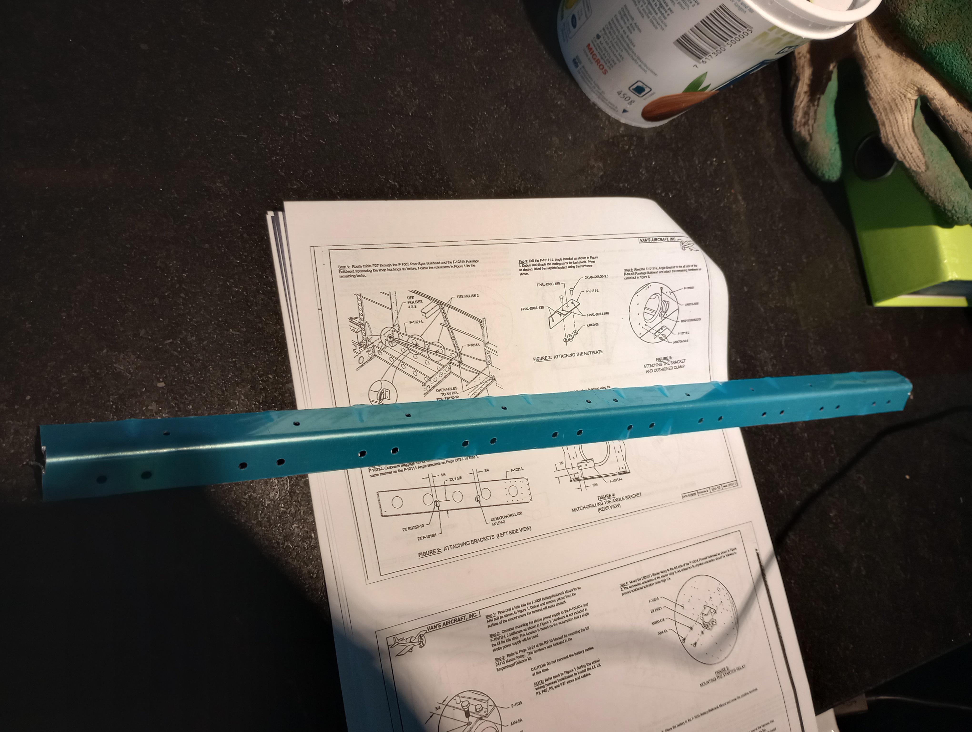

Hi there,
I found this part and first thought it might be the F1011 bracket for the cables, but meanwhile I doubt, the nomination would tell it is in the fuselage kit included, but referenced it is only in the cabling instructions.
[img]cid:part1.7kLuL25y.qNY2M0Jo(at)gmx.net[/img]
appreciate your help!
Cheers Werner

Werner, the cabling bracket called out in OP-37 is F-10111 (L or R) and it is only long enough for two left brackets and two right brackets.
Unfortunately, I don’t know what part you have pictured.
Tom
