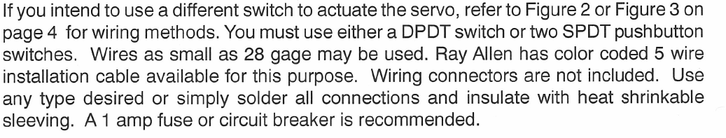

Are you using the Ray Allen trim servos? If so, it's worth noting that there are  thousands of them flying with power & signal wires bundled in the same cable, as spec'd & sold by the company. From the installation guide:
[img]cid:ii_lp2pseyd0[/img]
