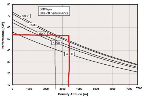

Dear all,
I'm in progress of flight test of my Europa and have come to speed
performance test. I will need to show the speed for 100%, 75% and 65%
power settings and for various altitudes.
I have some difficulties understanding what Rotax/Europa means when say
75% power.
Looking at Rotax power graph you have 75% power only up to about a
Density Altitude of about 3500 ft.
On the other hand Europa writes about the performance for 75%
power (at)8000 ft.
When talking about let's say 75% power, will that be 75% of the max power
the engine can perform a Sea Level or the 75% of what it can perform at
the actual Density Altitude?

Trying to attach a second file
The Rotax graph

looks right to me.... 2500m = ~8kft

Oops.
I did not notice, that the altitude is in meter. Now it all make sense.
