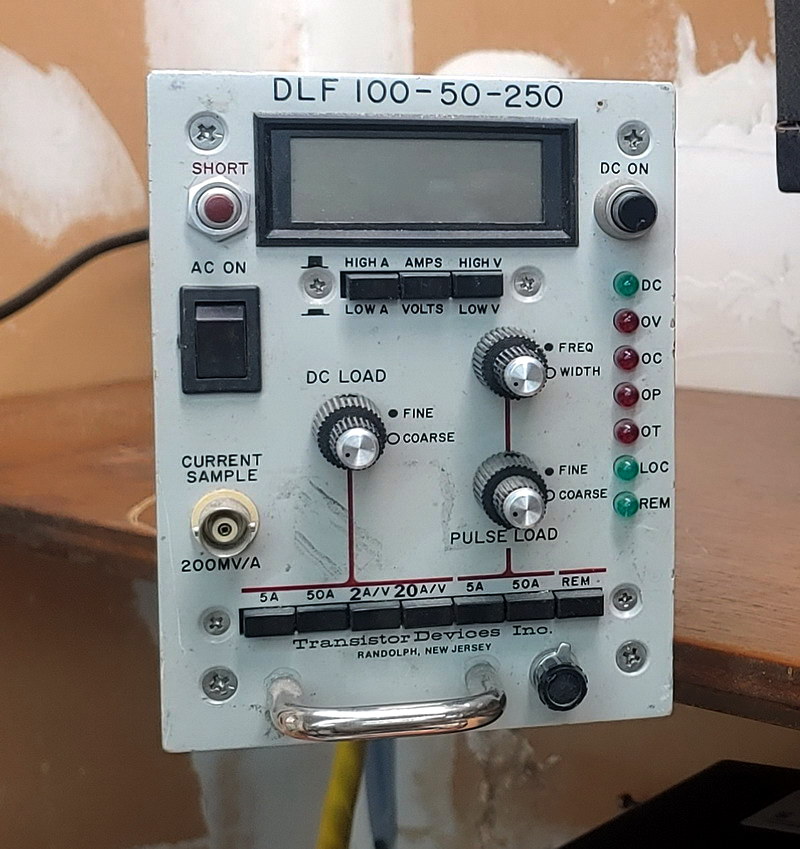

I've acquired a new tool for the mess-making
shop. Toward the goal of being able to test and
quantify performance on various components,
an accurately calibrated electronic load-bank is
of considerable value.
This critter will sink up to 250 watts with
max voltage of 100; max current of 50A. It features
a pulse generator that allows the load to be
modulated with excursions in both magnitude,
frequency and duration. I've not enjoyed this
capability since the last regulator I did for
Beech about a bazillion years ago.
It also has a scaled current sample port that
will drive my oscilloscope. This instrument will
be invaluable for evaluating a box of 'funky'
fuses.
