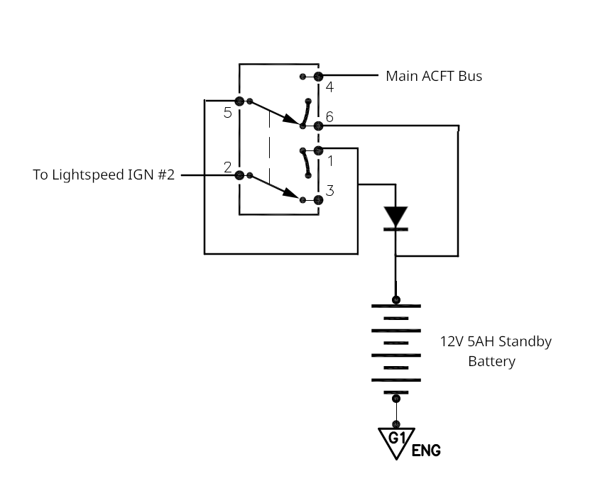

Have a pretty solid electric system derived from the Z diagrams on my EZ.
Going to dual electronic ignition and have high confidence in 2 alternators and a battery, but want a standby "get me down" battery since my 2nd alternator is an SD8 and it doesn't make power when the RPM is pulled back.
Switch shown here is a progressive switch. Off (down) is off. Up is normal main bus providing power to the ignition and charge current to the standby small battery. Middle position is isolating the ignition to a ~5ah 12V battery (EarthX or similar). Diode keeping electrons flowing to the ignition and not the rest of the world.
Have I missed anything? Thought was if the world is going to hell, One switch and I've got that ignition isolated and powered. Probably never use it, but...
Thoughts?
Andy

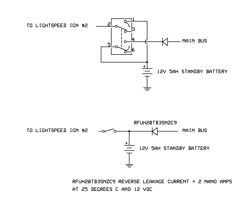

You are right Charlie. I was wrong. I mistakenly thought the battery was
supposed to supply power to the main bus. Below are two schematics.
The top one functions the same as the OP's. The bottom schematic is simpler
but accomplishes the same goal.

PostPosted: Sat Feb 03, 2024 4:25 pm    Post subject: Re: 2nd LSE Standby Power. Reply with quote
Lightspeed Ignition. Klaus recommends that #1 be tied to the battery - it is.
#2 can be tied to the main or essential bus. This circuit is only for #2.
Thought here is that it's a single switch (less failure points - arguable... More complex switch.) Master switch is progressive - alternator issue - click down to the center position. This switch would have the same mentality. It'd also never be a "Boldface switch flip" unless all power went away on the aircraft (Battery dead short, took out alternator and backup alternator - too many failures in that chain for this to be boldface.)
Any circuit issues with this design, along with a diode recommendation?
Diode reversed. Whoops - sorry about that. Fixed...
Thanks!
Andy

Joe,
You mangled my schematic and made it better. I had the diode in the wrong spot. In you configuration, in the top switch position, the engine keeps running if the battery bus dies, runs off of the standby battery. In my drawing it didn't.
Thank you! I think that's my implementation. I want to be able to get the 2nd igntiion as far away from anything else as possible, and that configuration does exactly that.
Thank you for the diode recommendation as well - perfect.

PostPosted: Sat Feb 03, 2024 8:17 pm    Post subject: Re: 2nd LSE Standby Power. Reply with quote
While the main alternator is running, the 5AH standby battery should be
connected to the main bus to keep the standby battery charged.
My last schematic accomplishes that with only a diode. There is no concern
of parasitic aux battery drain because the diode has infinitesimal reverse leakage current.
If the switch is closed, Ignition 2 will draw current from the source with the
highest voltage, which is normally the main bus, not the aux battery.
The definition of infinitesimal is the distance that an aircraft carrier sinks
into the water when a house fly lands on its deck. Smile
