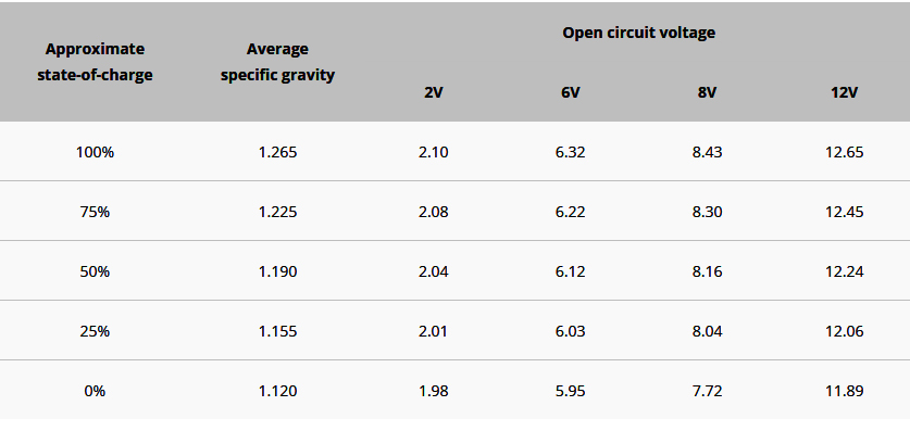

Note in attached figure (shamelessly stollen
off BatteryUniversity.com), 0% state of charge
on a 12 volt produces an open circuit reading
on the order of 11.9 volts.
You cited an open circuit voltage of 2.2 volts . . .
Hmmmm . . . less than 0% state of charge?

It may have been quite predictable. When
the battery is discharge to LESS than zero,
i.e. open terminal volts less than 12.0
V and SG below 1.12, then what's left of
the acid is free do mischief on the battery's
innards . . . like sulfation at an
accelerated rate.
