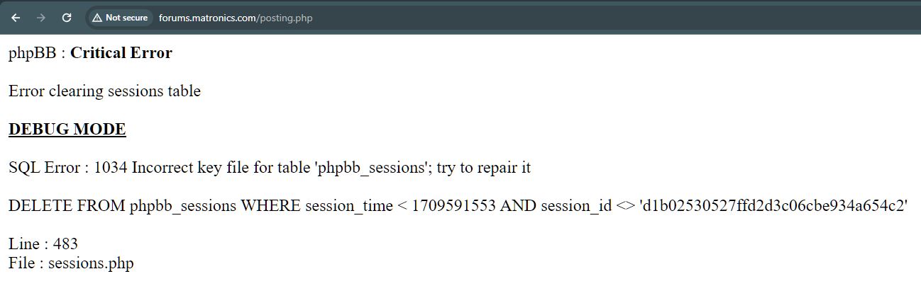

Matt, I've been seeing a lot of "phpBB : Critical Error" messages lately when viewing the AeroElectric-List web interface. Repeated forced-reloads will sometimes cause it to load, but it's making the forum virtually unusable.
Here's a screenshot, taken after clicking the "Preview" button on this post.
 Filesize:  52.97 KB
 Viewed:  12374 Time(s)

I also have been having trouble opening the AeroElectric List.
After trying several times, I might eventually succeed.
Below is a copy of the error message that I get:
Error creating new session
DEBUG MODE
SQL Error : 1062 Duplicate entry '1960' for key 2
INSERT INTO phpbb_sessions (session_id, session_user_id, session_start, session_time, session_ip, session_page, session_logged_in, session_admin) VALUES ('9803384edc1f80f8952e3ed4a46db8bf', 1960, 1709597076, 1709597076, '619ce26f', 3, 1, 0)
Line : 187
File : sessions.php

Internet Spammers fill up the Sessions table causing this error. I've cleaned the table, should work better now.
Thank you for reporting.
