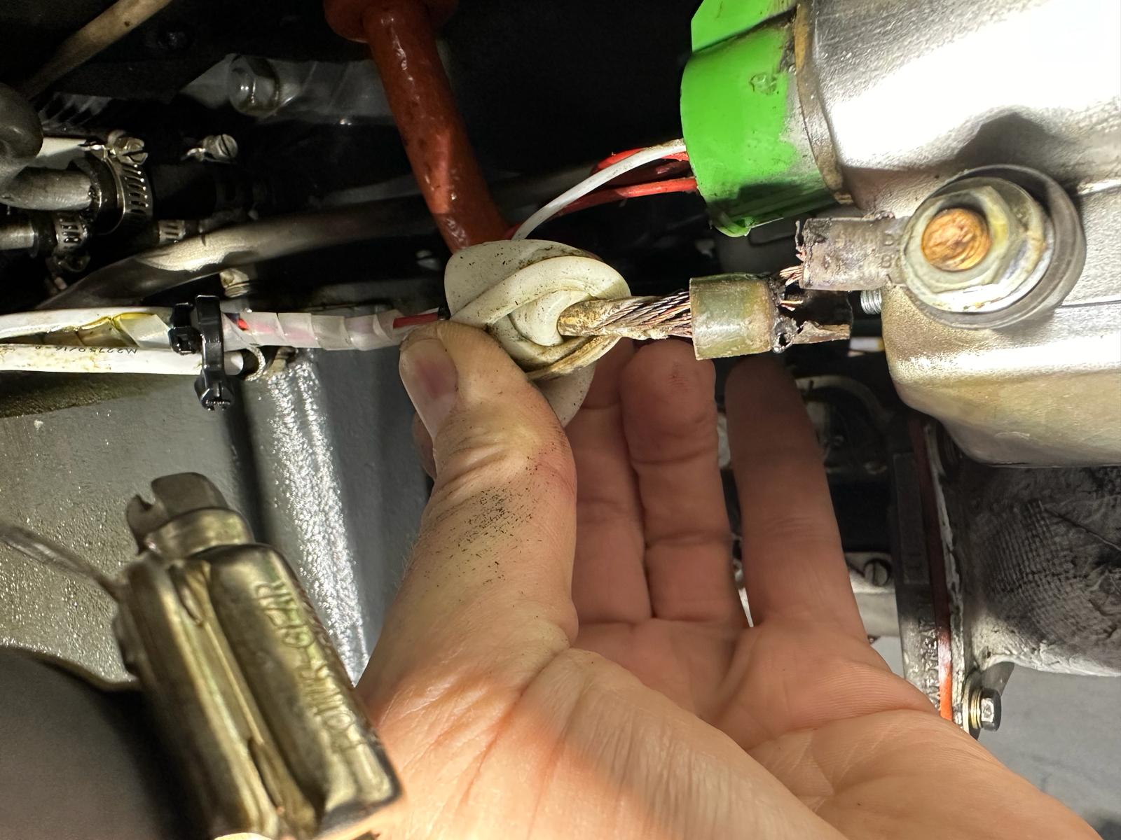

A related anecdote Bob …
On a recent VFR cross-country I had an under current warning on the EFIS during taxi for departure … indicating -17A from the battery.
Cycling the alternator switch and field CB did nothing.
I taxied back in and shut down, then restarted to see if higher RPM would help - the problem disappeared, but wasn’t normal for our aircraft.
We have an almost new 25Ah battery, so I got airborne knowing I could just load shed to get to the next destination 2hrs away if required (with maintenance options at the arrival location) - no problem getting there.
On return however, the same problem cropped up, so I load shed the GNS430, autopilot, and electronic ignition in the air and got down to -4A (ie about 5 hours battery endurance with EFIS, backup radio and iPad moving map).
After refuel and restart the problem was gone again for most of the last 1hr leg, then reoccured.
We suspected the alternator was failing (PlanePower EI70), but discovered the B-lead had almost completely broken through at the alternator terminal (under the silicon boot).
Perhaps the crowbar was stepping in and resetting after shut/cool down, what do you think?
Kind regards, Stuart

PostPosted: Thu May 09, 2024 3:00 pm    Post subject: Broken "B" Lead Reply with quote
It is unlikely that two things went wrong at the same time. Fix the cable and test fly it.
Crowbar circuits usually don't reset themselves.
Many of us can not open files with the extension p7s. How about a JPG or PNG picture?

stuart(at)stuarthutchison
PostPosted: Thu May 09, 2024 3:57 pm    Post subject: Failure Tolerant Architectures Reply with quote
For sure Joe.
The alternator is likely just fine.
B-lead fixed and all good now.
However, I’m interested to know how a damaged B-lead could cause intermittent normal then totally off-line then normal indications if the crowbar doesn’t reset during shut-down? As an internally regulated system all this would be part of the PlanePower alternator.
There was no pic in the first e-mail, I don’t know what p7s is but here’s a JPG.
Regards, Stuart

PostPosted: Thu May 09, 2024 6:23 pm    Post subject: Re: Failure Tolerant Architectures Reply with quote
The vast majority of electrical problems are caused by bad connections, not equipment failure.
And bad connections can cause intermittent symptoms as the resistance varies.
It is great that you found the problem and fixed it.
Good going.
