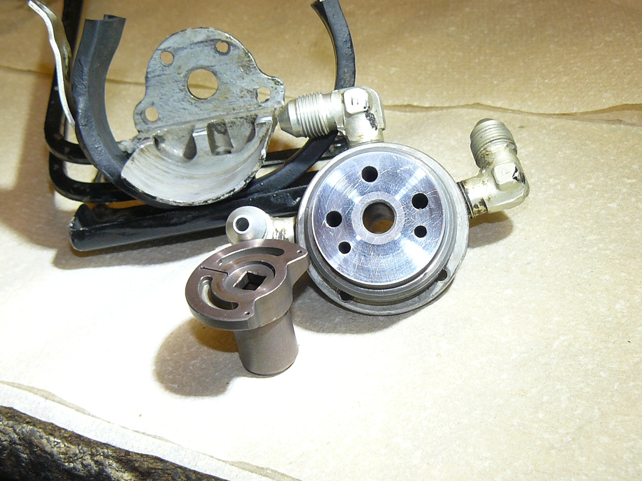

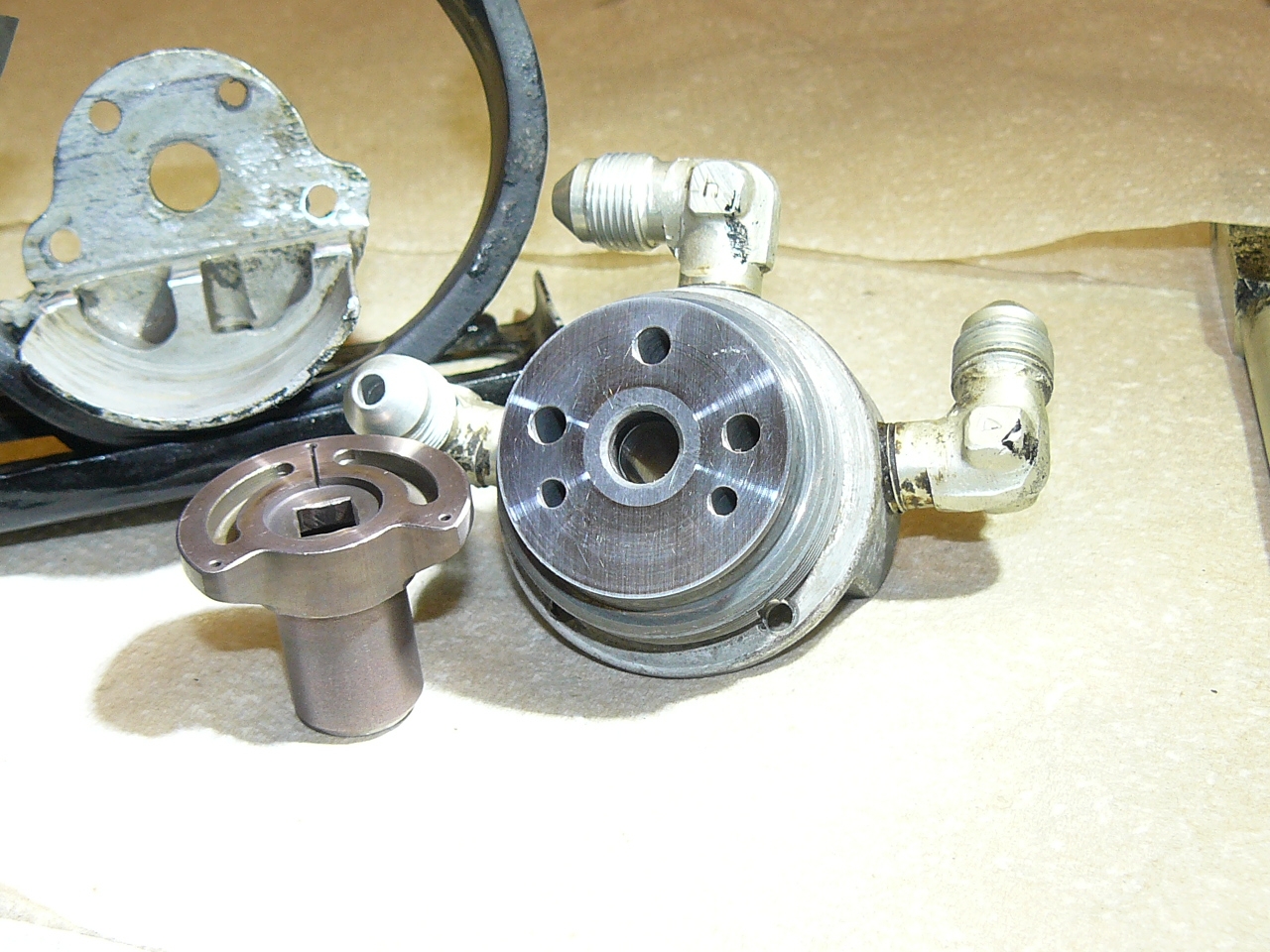

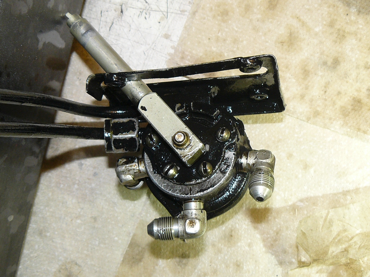

PostPosted: Mon Dec 02, 2024 8:03 am    Post subject: Re: Yak-50 MLG handle / valve Reply with quote
I would not know about any seals in the lg valve, at least not on a 18 T. The seals are perfectly lapped faces of moving parts , sort of disc valve. So my guess is rust on these faces. You can get diamond paste and lap both parts for nice finish and good seal. In assembling the lot a smear of clear chain grease will prevent corrosion and smooth operation. Any other quality grease will do when it is not too light strength.
Vic

Thanks for all of these replies. All very helpful, especially the pic of the disassembled LG handle/valve. Hugely helpful in understanding function.
I needed to ferry the plane to someone who had jacks, so squirted some air tool oil in the actuators. Amazingly this seemed to immediately return the gear to normal operation (simultaneous extension at normal speed) though the handle leak is still present. (at)Mark your comment about leaking in neutral an indicator of a bad handle makes good sense.
So, am removing actuators now and looking fwd / dreading seeing pics of interior.
Incidentally I had some old data from Tom Johnson on seal supply from the AC Depuydt Seal Co (dated 2007). Ctc info: https://acdepuydt.com/contact/
The chevron seals for the gear actuators are $23 ea and p/n is now MU-035045060-SNBR-90. Will advise when they show as to how simple they are to fit.

markbitterlich(at)embarqm
PostPosted: Mon Dec 09, 2024 8:59 pm    Post subject: Yak-50 MLG handle / valve Reply with quote
I did the same with air tool oil.
Then the hardened chevron seals disintegrated into chunks and by the Grace of God I got the gear down.
